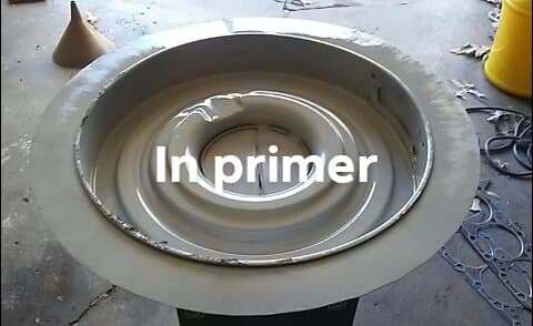

I've spent enough time moving this project around. Time to get back on it. I actually machined out a mold to press out he flange from a flat ring but I had a change of heart. I think rolling it might work better.
First step: Buy one of these jobbers.
Second step: Turn up some custom roller dies.

Tonight was time to cut a piece out of a scrap molding I had...
Take the top wheel off and go for broke.
So far so good. Time to cut the old flange off the blower so I can sneak up on the perfect size.
