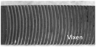

What I'm looking for, is any advice on finishing this "square." I do not have a mill or know anyone that does so I'm stuck hand filing and sanding. A preliminary check shows that the casting at least hasn't warped and is pretty darn close to square, just need finishing. My plan is to cut off the excess and then file off the flashing without removing any more than necessary. Thinking I'm more likely to cause more harm than good by trying to get a uniform machined finish with a hand file. Thoughts?

Vixen files work great on aluminum.
