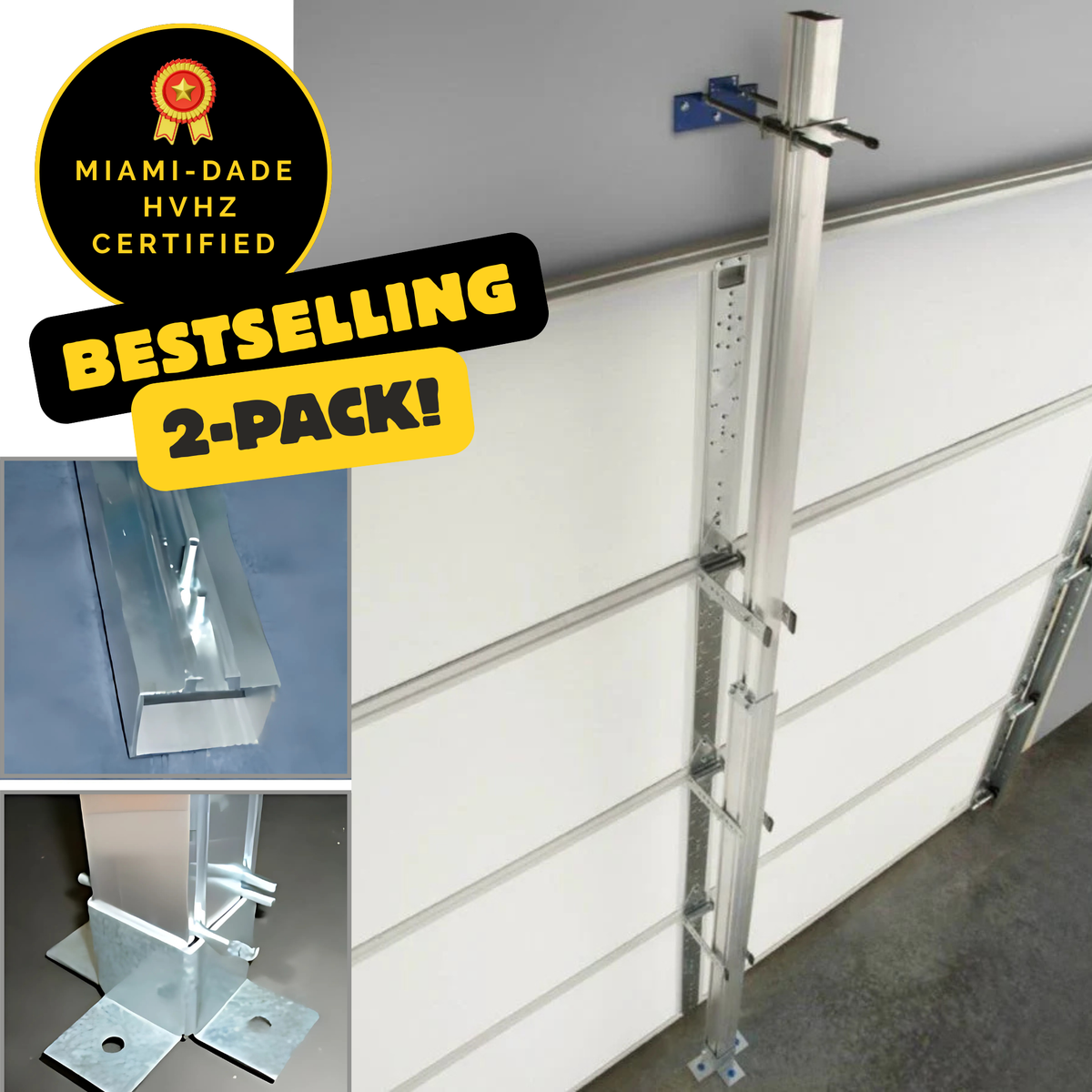

Yeah, the door is usually the weak link. They do make kits to really brace the door. It requires installing a couple parts when a hurricane is predicted. When we lived in FL, I installed a 'hurricane proof' door, and it was a monster.
I wonder if I could just throw a 2x4 in front of the door, screw it into the header and have a bracket on the floor screwed into the concrete. Sure cheaper than $600

I'm sure it would be fairly easy to come up with a DIY version. I know I could. One system I saw had threaded inserts epoxied into the floor to hold the bottom of the brace.

on my door, I added angle to inside so I can bolt more angle to keep the wind blowing the door in, and then the door bolts to the angle I added. so on the inside i got (4) 10 foot angle crossing the door for each door
