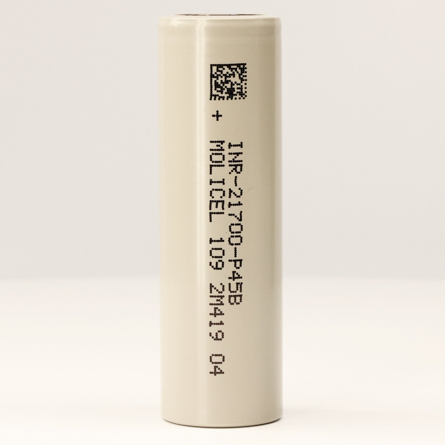

For $50, I took a chance and ordered one. When it arrived I was surprised at how solid the housing felt. It's polycarbonate, just like OEM Makita batteries. When I opened it up I was even more surprised to find a management board with a microcontroller, bms chip, cell balancing, temp sensor, shunt resistors for current monitoring, and 3 110A mosfets for emergency cutoff.
The battery also contained Lishen LR2170LA cells. Lishen is a lesser known Chinese manufacturer, but everything I found said these cells perform somewhere between Samsung 40Ts and Molicel P42As. In other words, pretty damn good. The only real problem was the thermistor on the board wasn't bonded to the cells, but that was an easy fix. For $50, this battery was an absolute steal.
I ordered another. When I opened it up I was pleased to see the thermistor had been properly bonded to the cells, but instead of the Lishens, this pack contained Samsung 30Ts. These are quality, high-current cells, but they add up to 6Ah, not 8. I was disappointed since I wanted a pair to use in my lawn mower, by far my highest-draw LXT tool.
Then it happened. I found the same battery shell/circuit boards being sold as a kit on Aliexpress for $16 each. I ordered two, along with 20 Molicel P45Bs. Today, I fired up my home-built battery spot welder and got to work:
The build went smoothly, all the parts are well made and fit together nicely. I added some additional nickel strips to the positive and negative terminals on the circuit board for extra current capacity, assembled the pack and threw it on the charger.
A while ago, YouTuber Tools and Stuff did a runtime test of the XGT and LXT versions of the Makita dust blower. The LXT version ran for 12.5 minutes. At the end the 5Ah battery was extremely hot and had to be cooled down before it could be charged.
My results: 25.5 minutes, and the battery pack was barely warm. After the pack recharged, I opened it up and checked the voltage of the cells and all of them were within 0.002V. This is better than the 0.05V balance the cells had when I assembled the pack, so I think it's safe to say the cell balancing works.
I'm going to call this a success.

The pre-built one? They go in and out of stock, so they don't always show up in search:
The kits came from Aliexpress. I haven't seen them anywhere else:
The Molicel P45B cells came from here:

He's going to run into problems with those. He's putting in the highest capacity cells he can find. That will work just fine running an LED lamp, but power tool batteries need cells with a high current rating.
There is a inverse relationship between current rating and capacity in most cells. I could have filled my battery with higher capacity cells, but the P45Bs are the best compromise between capacity and current rating right now, as long as you aren't talking about tabless cells.

Mine are working fine. I've also built 4 more batteries; two more with P45B 21700 cells and two with P30B 18650s to use with my leaf blower. I also upgraded the BMS boards on my older set to the new 5 mosfet version. All of them are charging fine on Makita chargers.
I'm not sure what is causing Yoke's issues. I don't think I would expect these to work with Makita debugging software, though. That would require a level of reverse engineering that would draw the attention of lawyers.
