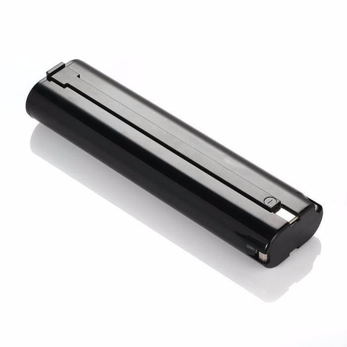

My first cordless tool was this Makita drill. As cordless tools go - this one is high quality.
It has been sitting up for 20+ years because my batteries would no longer take a charge.
It uses Makita Battery 9000. These are 9.6 v batteries.
I dug it out and bought a "replacement" battery off Amazon. While the battery fit - it would not take a charge and got very hot.
Anybody have any suggestions for a source to buy a decent battery or to have the old batteries replaced.

Our local CL often has Battery Builders ads for guys who will rebuild them for you. Slightly cheaper than Makita.
I also bought some in 2015 off eBay, both 9.6 and 14.4v. decent quality at a decent price. Don't see that listed right now, will fish the brand out later, Masione, made in China

A battery made with NiMH battery cells might not charge properly in some chargers.
I don’t know whether this is the issue or not, but it could be.
NiMH tool batteries only started to be a thing in the USA around the time Milwaukee introduced their first Lithium battery powered tools.
Even after NiMH tool batteries started to be made, numerous manufacturers still only sold NiCd batteries and tools in the USA, even when the same manufacturers were selling NiMH tools in other parts of the world.
For this reason, some cordless tools have chargers that can safely charge NiMH batteries, even if the tool manufacturer never sold NiMH battery tools in the USA, since the charger software was mostly universal thru out the world,
Older chargers from those same manufacturers would not have been made for NiCd though.
The charger should list what types of batteries it can charge.
The same issues happened with the switch over to lithium batteries, which is the reason newer batteries are sometimes designed not to fit older tools or chargers.

The local Interstate Battery center here will rebuild tool batteries. I took some DeWalt 14.4's in about 15 years ago. I have to admit to not being impressed, but battery technology has increased by leaps and bounds since then.

Update on my "old" Drill.
I took my Makita apart and found the contacts for the battery were "green".
I cleaned the contacts and put a fresh battery in. The battery proceeded to "cook" the switch. I'm not sure why but the switch started to smoke and then it was done.
I bought an identical drill off eBay ($20). I took the "donor" drill apart and removed that drill's switch and battery contacts. I soldered the "donor" parts into my old drill and everything worked fine.

Update.
I got batteries rebuilt by MTO. Very happy with the results.
I‘ve really enjoying using my old drill. Plenty powerful for my projects.
Yes, my Rigid and Kobalt are more powerful but it is fun to use an old tool that I built projects with for my kids - all who are as old as the drill.
