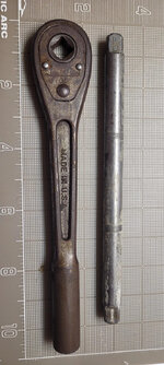

Do you have a pic? It may be for old school ratchets that only turn in one direction. To go the other direction you would push the anvil through the other side.

So the one larry g shows gets pushed thru, the one you show gets pulled out then inserted in the other side. How old is a ratchet like that? I've seen them, but never had one.
That one's a Craftsman with a manufacturer code of BE (New Britian), so acc'd to the Craftsman Hand Tool Manufacturers & Date Ranges thread chart it's 1931 to 1947.
BUT, that was just an example I found an image with both the ratchet and an extension like you described. You can still buy new female ratchets today. To use a female ratchet for a socket you would need a male-to-male extension of some length. We use them at work for machines that have 1/2" square shaft adjustment mechanisms.
