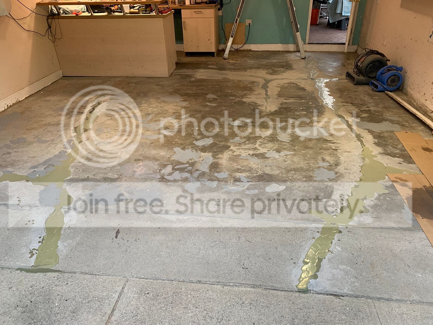

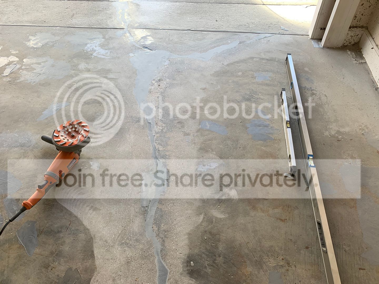

The floor was bad... the old paint was peeling, but worse were the massive cracks up to an inch wide due to what I think was just an poorly laid slab that resulted in settling on the two sides where the outside walls sat... I'm not actually sure if there's any steel at all in the slab, but it doesn't seem to have moved in the four years we've been here... the cracks had previously been filled with mortar that has just loosened and cracked away over time.
To be totally transparent, I'm in Northridge, CA so some of the floor damage could have been precipitated by the earthquake, but I honestly think it was just poor workmanship!
Here's the floor once we removed the massive sliding barn doors, moved everything out, ground out all the old mortar and opened the cracks up for repair... more to come...

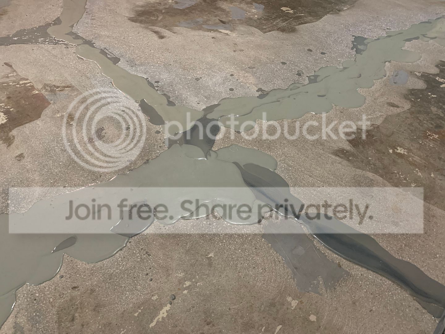

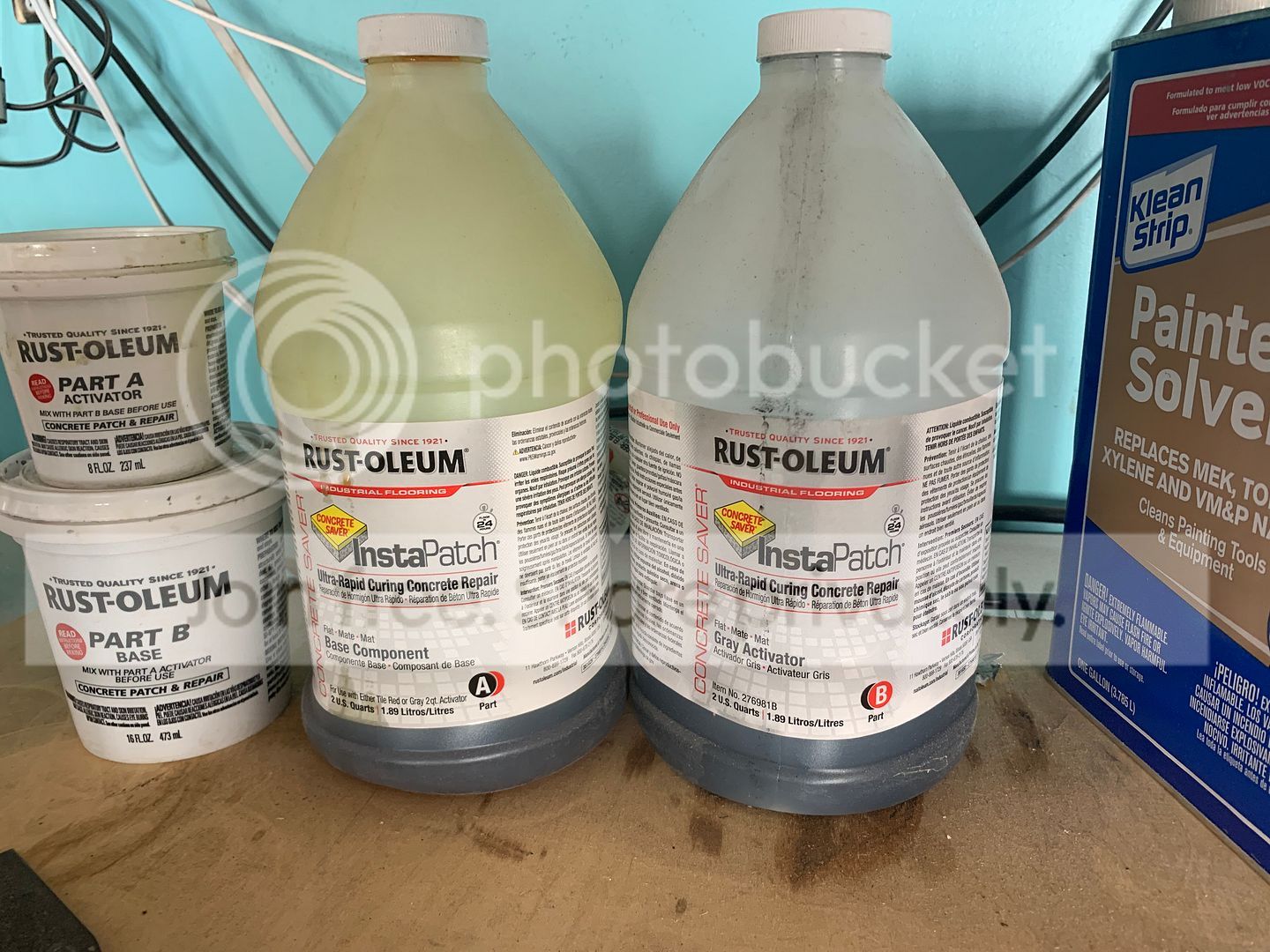

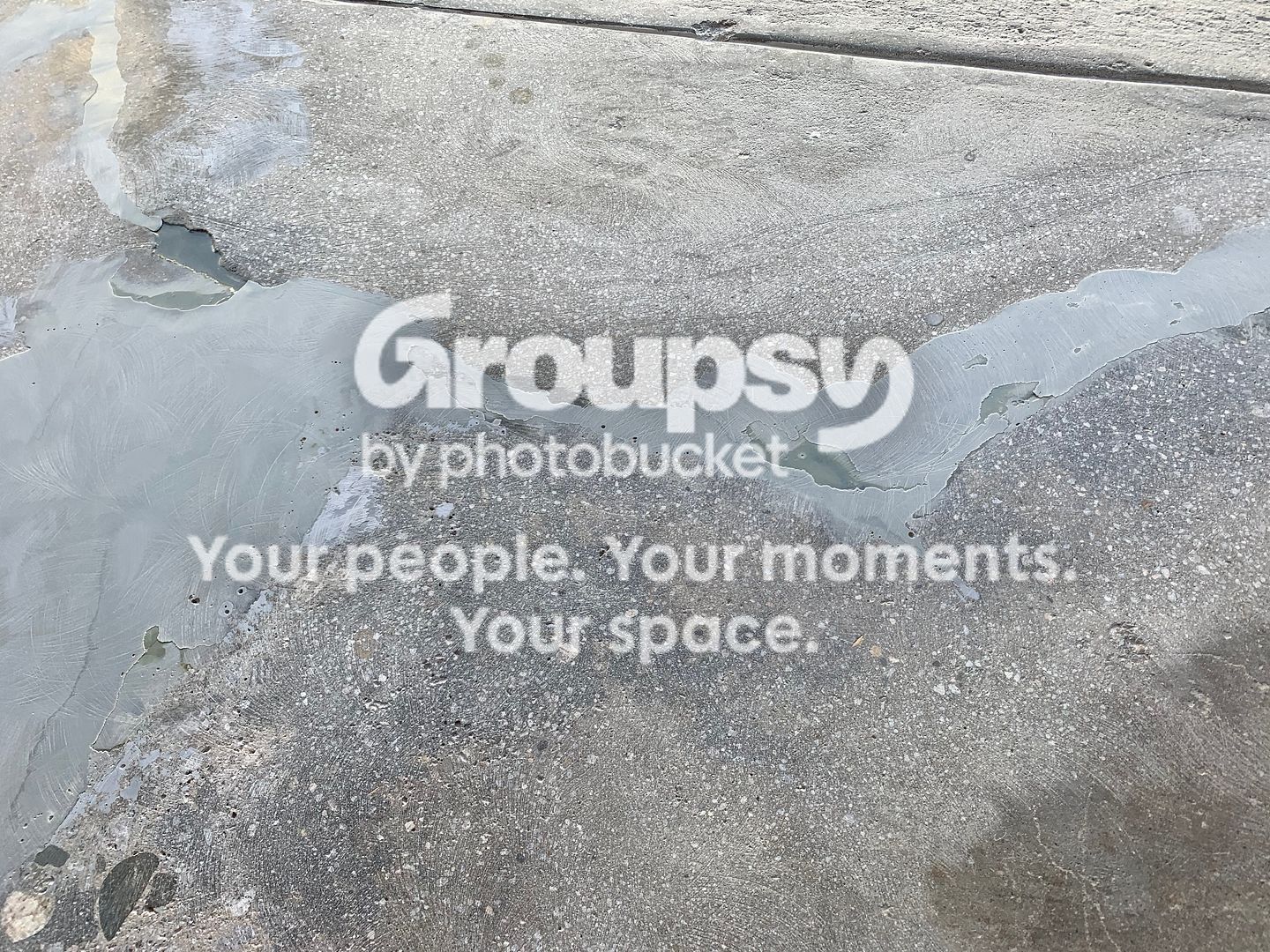

Used Rustoleum InstaPatch to repair most of the cracks. (the two large bottles) This stuff is expensive but it's amazing. You can only mix around 4oz each of part A&B because you only have around 3 minutes of working time before it starts to cure, and when it begins curing, it literally goes solid as it's pouring! (measured the temp and it gets up to around 250 degrees when it's curing!).

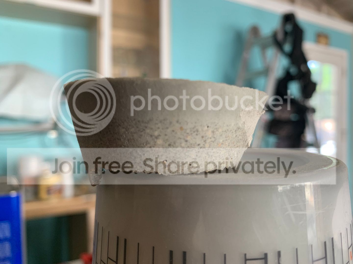

Built the deep cracks up by pouring a layer of silica sand and then pouring the InstaPatch on top. Tried a sample pouring onto sand in a paper cup, and the Instapatch penetrates almost an inch into the sand before it cures, and it sets like a rock!
Built up the cracks gradually and over filled so I can grind it flat. Used almost three packs to do the whole job ($130+ per pack) then used the two part epoxy to patch the small divots and holes. Once it's prepped, I'll epoxy coat the floor.

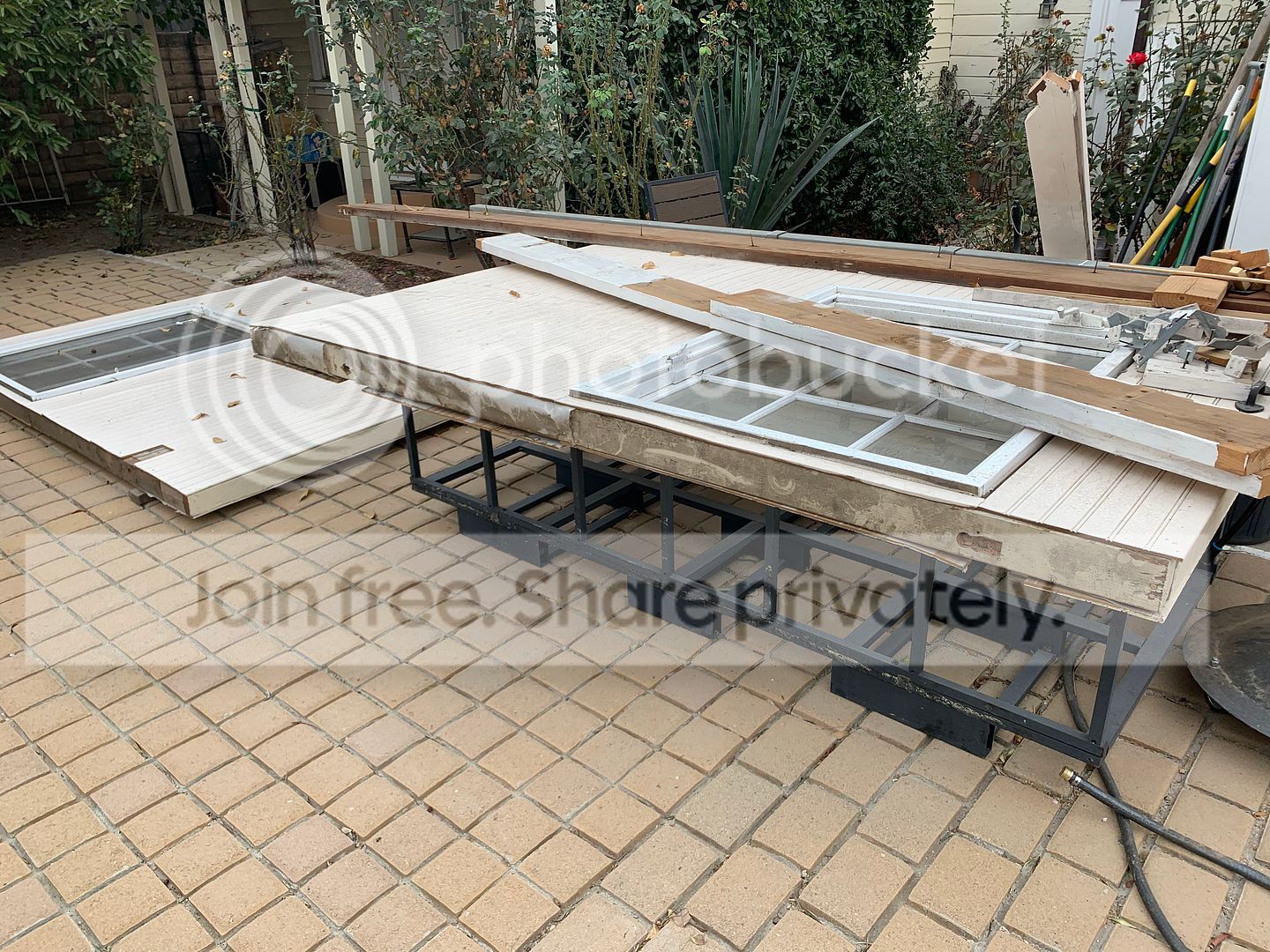

Before grinding and finishing the floor, I wanted to figure out what to do with the doors. The original doors were a massive pair of sliding barn doors that were so heavy, they caused the bulkhead to sag and just dragged on the floor. I had adjusted the rollers as far as they'd go and they would eventually sag some more to the point they would drag on the floor again and were almost impossible to move. There was also absolutely no weather sealing, so the dust just blew in around every side of them.
When I took the doors down to work on the floor, I really liked the feeling of having the room opened up onto the courtyard, which we hardly even use! So then started thinking about patio sliders or bifolds that would open right up.
Initial quotes for various bifold or sliding door systems started at $12K plus (in vinyl!), which caused me a little pause! (Should I just refit the old doors???) Time to either figure out a lower cost practical solution or just shelve the idea for now.

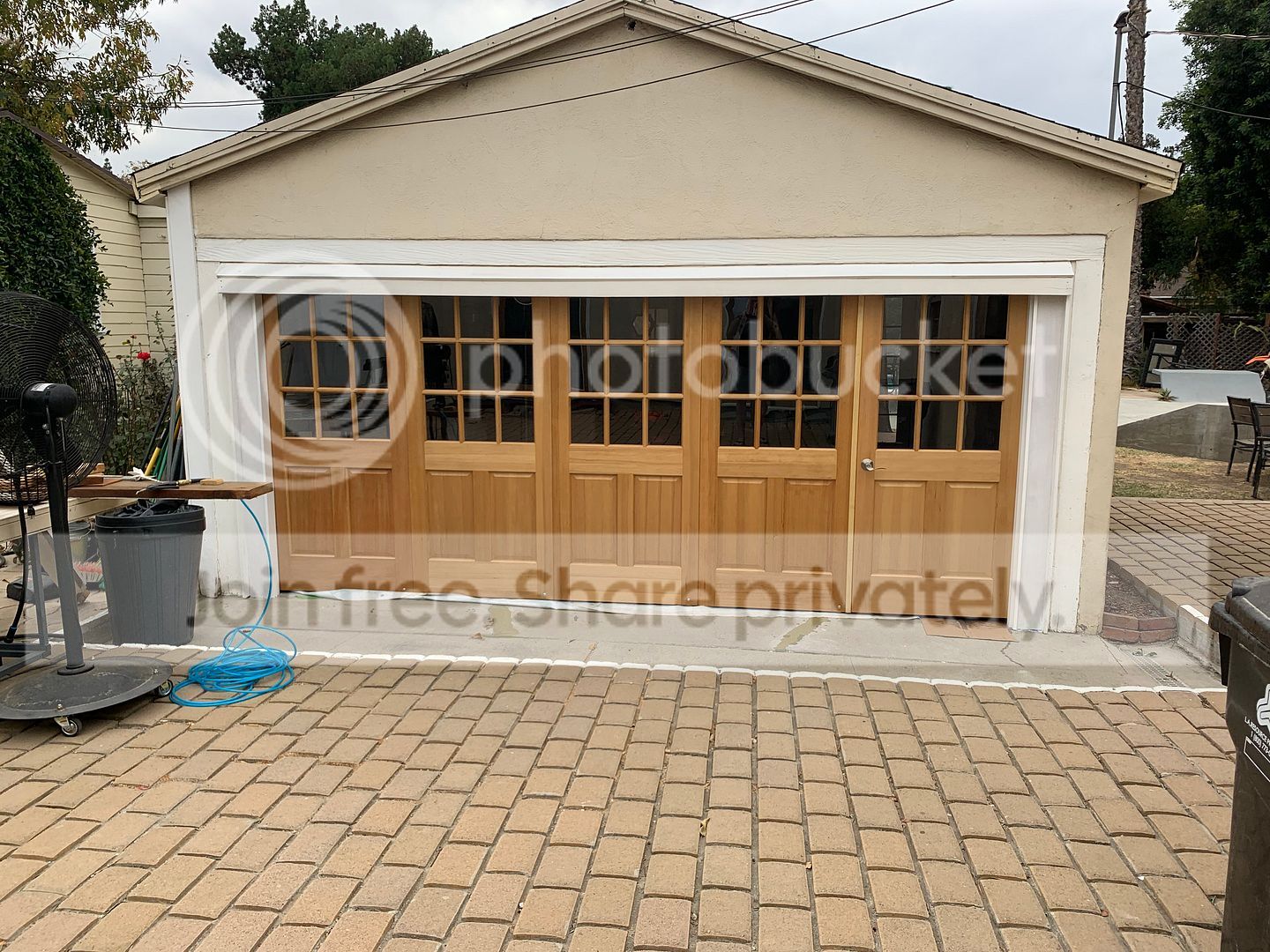

Because of the cracks and the way the floor drops on both sides, there's around an inch difference in height between the center and the outsides. (3/4" on one side and 1" on the other) So I needed to come up with a system that wasn't going to rely on floor rails, plus I wanted to avoid any form of sill if possible so there's a clean transition from inside to outside when the doors are open.
I only anticipate opening them up occasionally, when we have a party and the weather is conducive, so started working on a hanging design using the existing sliding rails and rollers. Initially considered a bifold, with center hung roller, but there's a small awning box that would obstruct the half of the doors that would swing outwards, and it would be more difficult to weather seal the top edge, so ended up going for an end hung roller with independent doors that slide to the end, then stack together at the end.
Found some solid wood 9 light doors at Home Depot for $206 each. 5 x 36" doors would work, so just over $1,000 for five doors and a few hundred bucks for hardware, I figured I could do it for under $1,500.

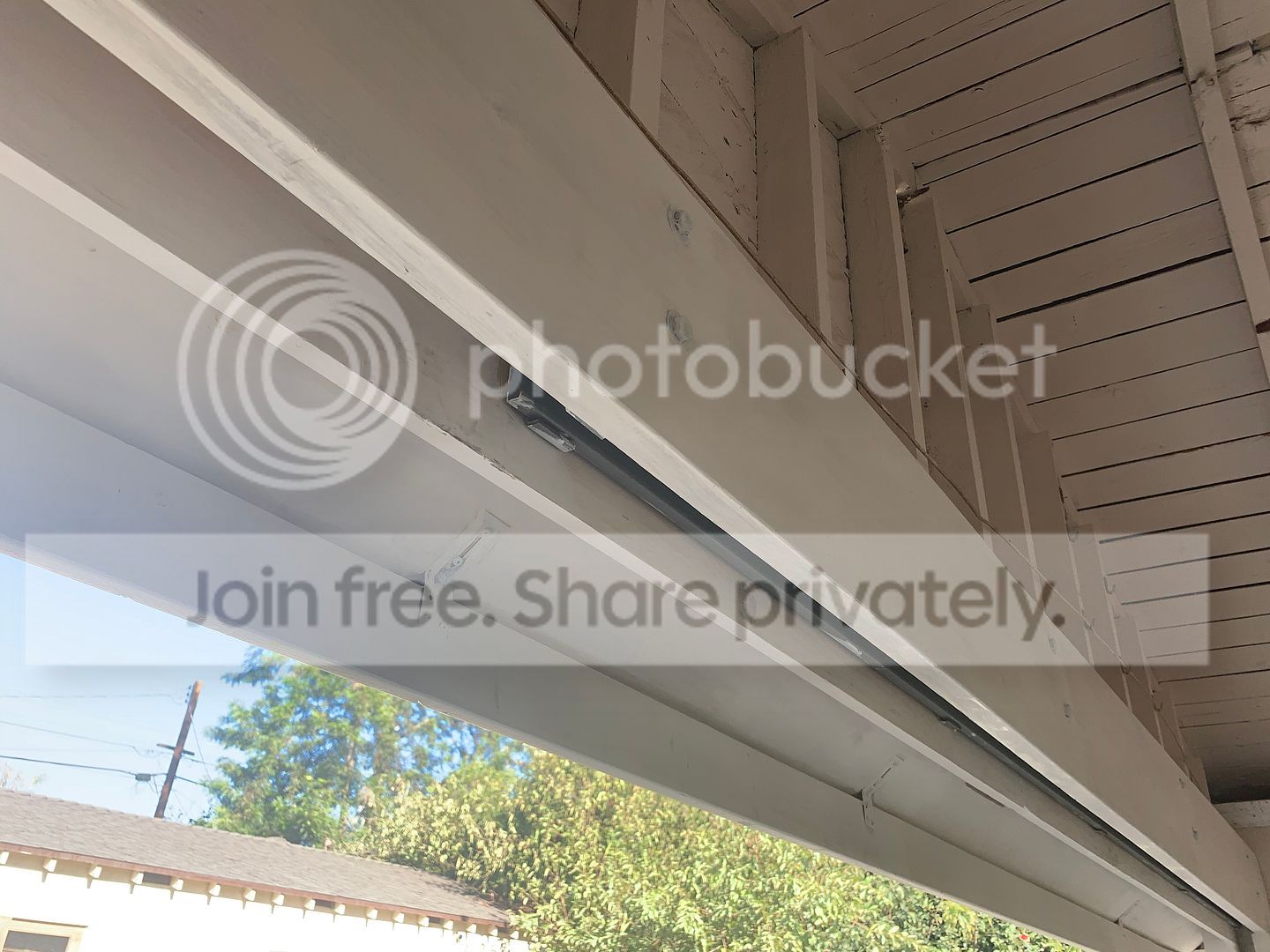

First, needed to reconfigure the sliding rails, and create clearance for the doors to swing inward under the bulkhead. So pulled the original bulkhead out, reconfigured and replaced with a new 12x2 bulkhead.

For the first time ever, my 18 year old son showed some interest in a project, and started helping me... he now has an appreciation of the sense of satisfaction when you make something yourself, and solve problems, and he seems disappointed if he wakes up late and I've done something without him! Now I just need to work on the waking up late thing!!!
Forged a more compact mount for the sliding rollers and mounted to the top corner of the door, and mortised a recess in the opposite bottom corner and inset a rollerblade wheel, so the doors roll along the track regardless of the floor level, but will also swivel out up to 180 degrees. The edge of the door needs to be lifted to swing out... I couldn't find a recessed ball roller that would work, but I could retrofit later if I come across one... so the roller blade wheel only rolls along the door axis. Since I only see them being opened up occasionally, I didn't consider this an awful compromise for now.
With the uneven floor level, this means the doors are all sitting at different angles, so we set two dowel pins and mounted adjustable latches which pull the doors together, so now, each pair of doors is aligned and hanging on the roller of each pair, which can now be adjusted to get the right alignment.
Mounted spring loaded foot operated door stops to secure the bottom of the doors and a slide bolt to secure the top. (the slide bolt sits inside the bulkhead so it prevents the door swinging out, but doesn't prevent it sliding.

The Instapach wouldn’t work in a caulk gun... the two parts are both liquid. When you combine the two parts and mix it, it’s the consistency of really thinned paint... you have about 3 mins to pour it into the cracks before it starts to cure.
My first attempt, I mixed too much an it actually set hard mid pour and I had one of those Coke Can style ornaments!

I had around 6-8" either end after allowing for the five 36" doors, so I built out the frame on the side where the final door (the everyday access door) would swing, and mounted the door. That way I could fit the final door hardware and see exactly how much I had to build out on the final gap. The intention was to have the swinging door close against the last sliding door.
I used adjustable clips to join the doors, but I was undecided whether to add a rubber weather strip between each pair of doors or not. The adjustable clips gave me the flexibility to do decide later. But that would be 4 weather strips, so if they were 1/4" thick, there could be a difference of a full inch between including and not including them... if they compressed further over time and ended up 1/8" each, that could open the gap between the door latch and strike plate by 1/2". Even the thickness of a few coats of paint of other finish across five doors could impact the final fit. Then there is just shrinkage as the doors age and settle... So I needed a way to adjust the final connecting point.
I welded nuts to some base plates and used long bolts countersunk into the final piece, with fender washers and springs to create an adjustable jamb so I could fine tune to final fit, and adjust it as needed later.
Finished the doors with a Tung Oil finish, rubbed with 0000 steel wool and mineral spirits between coats... I'm happy with the overall result... now back to finishing the floor. (I didn't want to finish the floor until I knew what I was doing with the doors, in case I needed to drill holes for slide bolts or add a sill etc.)

Back to finishing the floor... started grinding the InstaPatch, and this stuff is tougher than the concrete to grind! Using a 7" diamond wheel and it's slow going!
One thing I have learned is that this stuff doesn't adhere so well to itself! I built the cracks up and in a number of placed the floor on one side of the crack was significantly hiher than the other, so I over filled, expecting that I could gring a gradual transition into the InstaPatch, but that's not looking like a solution... once the top layer of IstaPatch gets thin, it begins to separate from the layer below it. (Tried not working the same area constantly to see if it was a heat issue, bus doesn't seem so... I'm findind that I will either need to scrape up the sections that are not adhering, and refill with the regular epoxy, or I'm having to grind the concrete further out to bring the high side down so the InstaPatch is just filling the crack.
Still have a ton to do, so I'll see how it goes as I get to some of the other areas.
