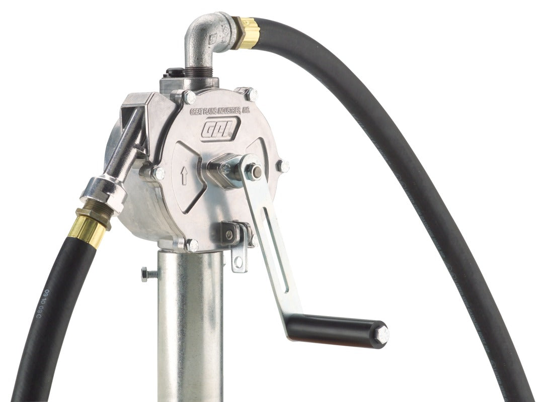

A friend of mine has issues handling the large 5 gallon gas containers for fueling their outdoor power equipment. It's much easier for them to transfer the fuel into smaller 1 gallon tanks, and use those to fill up tools as necessary.
The problem is the piston-style plastic "fuel transfer pumps" from Autozone only seem to last for a few months before they start dissolving. Does anyone have any recommendations for a manual fuel transfer pump that can hold up to gasoline? Not interested in anything electric, and it's got to be able to have a hose (or otherwise fit into) a standard 5 gallon gas can.

Neighbor used those, they don't last long and he finally gave up. . He now uses a siphon that last much longer. You do have to get the can up to the level of the tank however.
https://www.amazon.com/Action-Pump-Polyethylene-Siphon-Gallon/dp/B00866CNV4/?tag=atomicindus08-20
Do those hold up to gasoline?
That could be an option, but it really comes down to is if its seals can handle gasoline. I've seen a lot of pumps "rated" for fuel, but what they really mean is "diesel", and they just don't live long with gas.

I got one of these. All metal except for the rubber plunger, advertised for gas, diesel, etc. Well built for the $20 but I have not had a chance to try it yet, will post if I get a chance to use it this weekend:

Success, I pumped about a gallon of gas today. It worked pretty well, took around 10-12 pumps. Pulling ***** gas in, pushing pumps gas out. No leaks👍 The pull stroke did **** some gas back into the output tube, about a foot or 2, but not all the way to the pump. I assume that the check valve was allowing back flow but really not enough to matter. It could have been just my pump or it could be all of them - more reports needed!
I unscrewed the end and looked at the rubber seal - unchanged - but time will tell. I got this specifically for gas and will report back if the seal deteriorates. I did not think about static electricity until later, I've always been told to keep both containers on the ground if possible, not sure if this helps or not.
All in all, I perfectly happy at this point. $20, it pumps well and does not leak onto my hands.

Almost all of these solutions NOT using 12VDC are expensive.
Totally enclosing the electric side and the pump in a sealed box should absolutely provide spark safety....
Even if you use a lousy old Facet style clicky clack low pressure pump and let it run until it ***** the 5 gallon jerry can dry in 30 minutes beats spending $400 to $1000 for a wobbly manual fuel transfer pump or a pneumatic one.....
