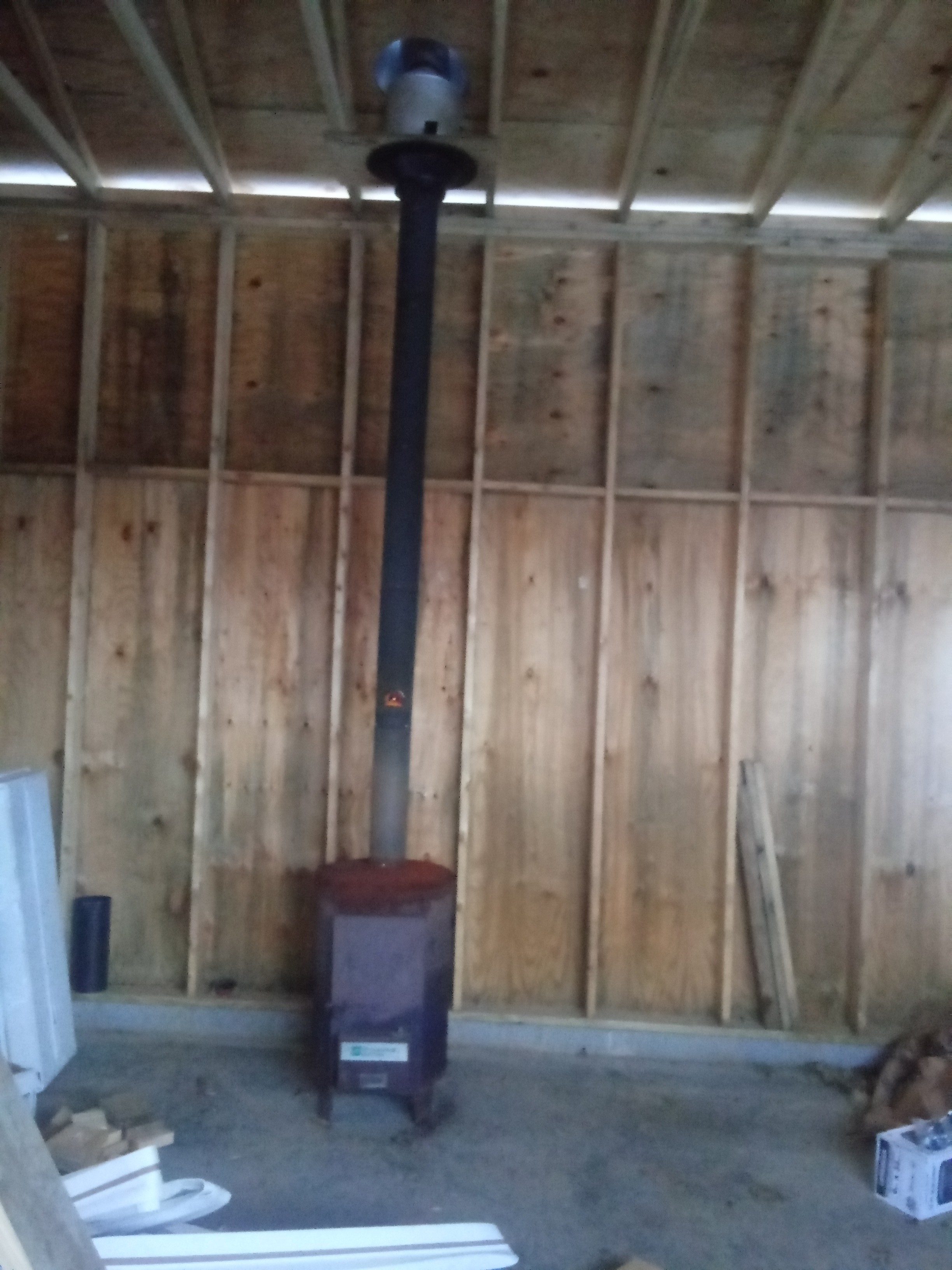

I also got this installed, but still need a heat shield for the wall behind it.

Did you discuss the wood stove with your insurance company? I am considering using one also. I have read a lot on the forum that most insurance companies will not cover a fire if you have a wood stove. I still have yet to call my insurance company and ask.
mvusse
Aug 21, 2018
87
Strasburg, Ohio
They want to see the stove in person, but (with the heat shield installed) it should be fine. I just have to remind me to call it a "shop" and not a "garage". If it were a garage I can't have any open flame less than 4 feet off the ground. In a shop that is no problem. Go figure.

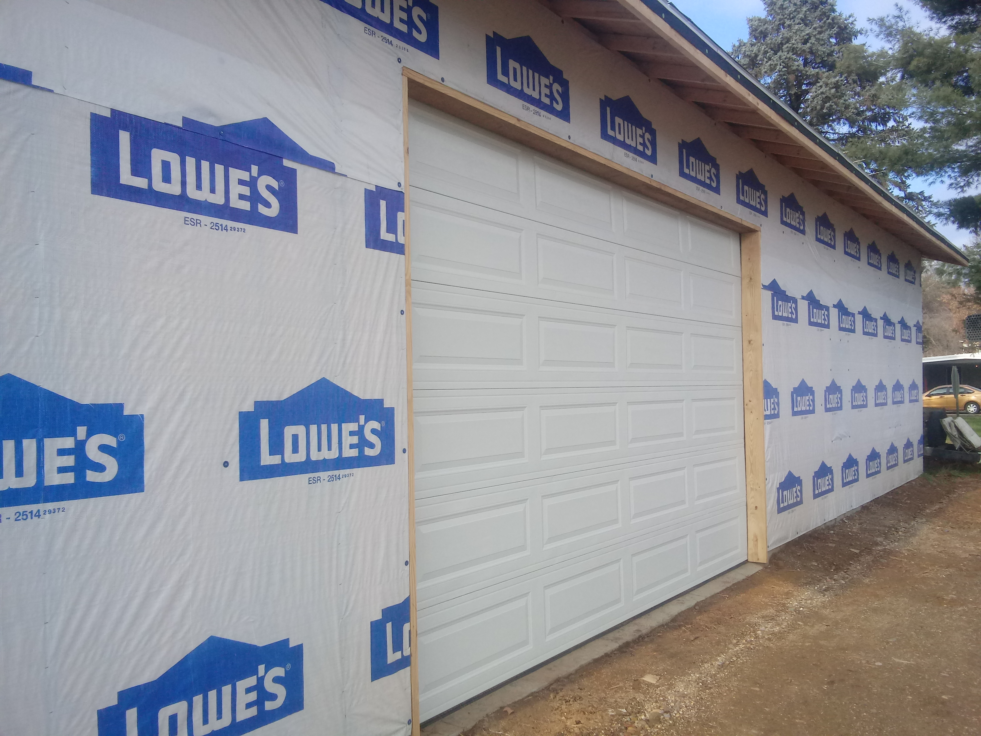

So here is the first garage door installed:
And the second door I installed last Saturday:
Currently in Canada for a week, but in January I should be able to get the windows in so I can start on the vinyl siding,

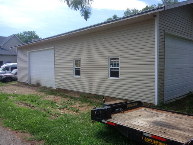

The roofing felt is doing a great job keeping the garage dry, so I decided to do the siding first and the shingles last. This spring, though, just like last year, every time I had a day off it was either raining, or had just rained, and I did not feel like standing in mud installing my siding.
It did eventually dry up a bit. Two weeks ago I got the first wall done:
And two days ago I got the second wall done:
mvusse
Aug 21, 2018
87
Strasburg, Ohio
Finally got the siding done on the last wall. Still need to do the soffit and shingles, but first I need to get the Jeep back on the trails and I now have a deadline to get my equipment out of the old shop (and in the my new garage).

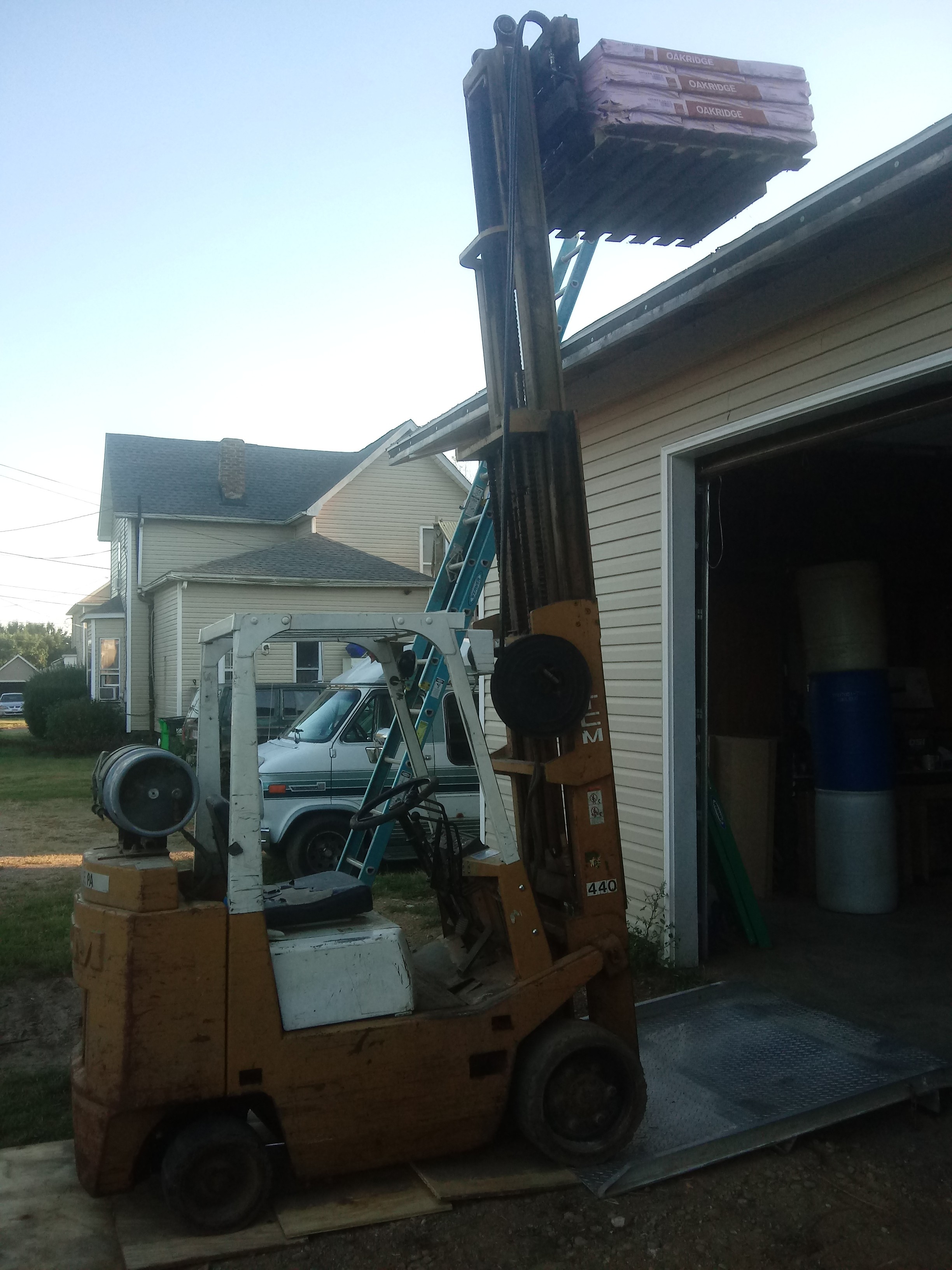

So after fixing the Jeep, breaking the Jeep, stuffing an 8500 sq ft wood shop into a 1200 sq ft garage, and fixing the Jeep again 2 months had gone by before I finally got the shingles onto the roof.
I got about half the pallet unloaded like this, until the mast got in the way for the remaining bundles:
So then I turned it around and got the rest. Sure beat carrying them up a ladder. About 4000 pounds worth.

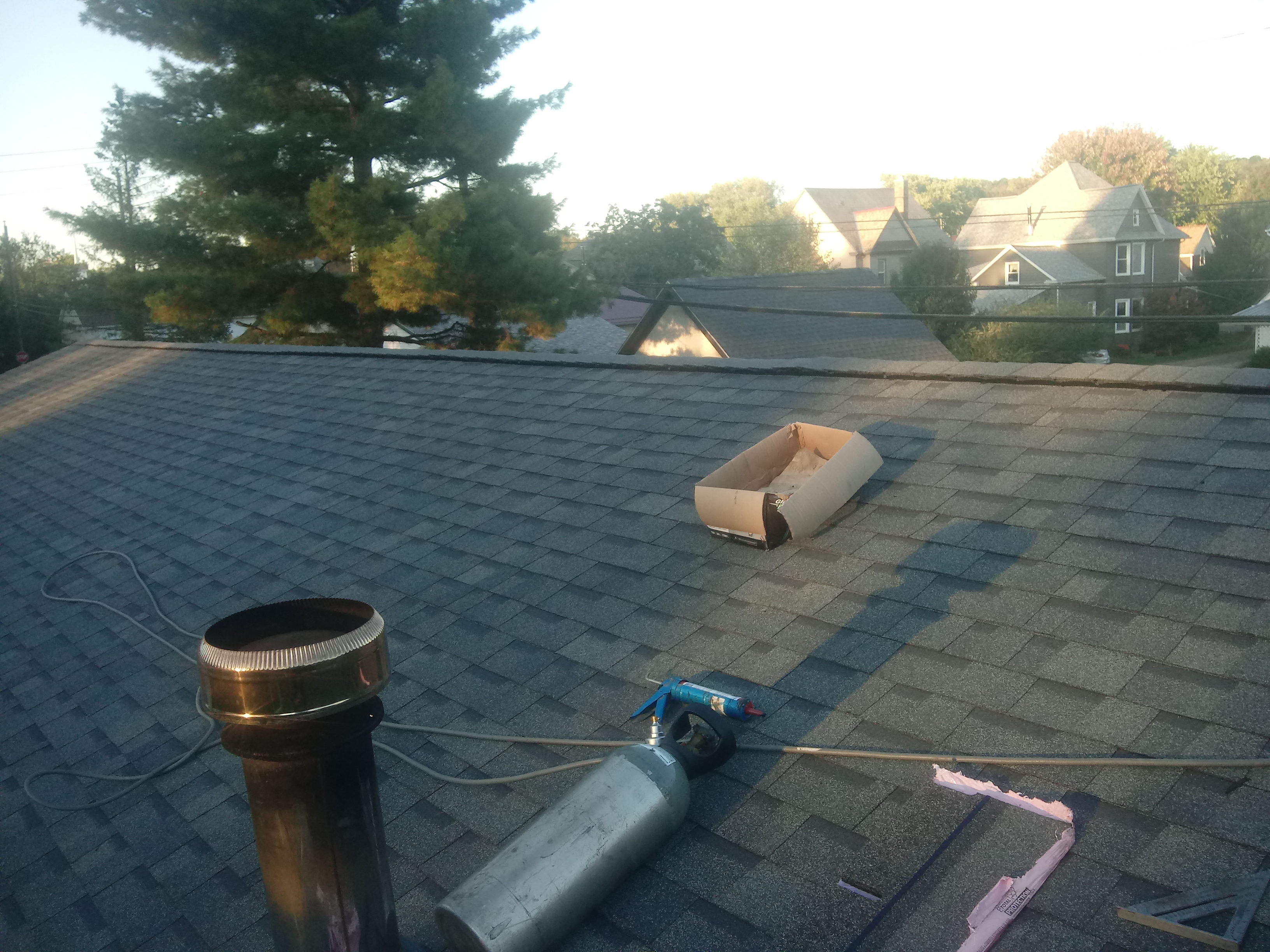

I then started on the shingles.
Day 1:
Day 2:
Day 4, ran out of shingles before I ran out of roof:
But after a quick trip to Lowe's I finished:
A few days ago I got the ridge vent and cap shingles on:
