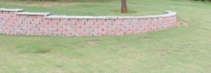

These are the walls. They have been in place for 3 years now, are stable and function exactly as we wished. Just need to permanently adhere the stone to the tops.
Still have some work to do on my steps. Heading out in the yard right now to do that.
I understand this is your place, and you have a look you are going for, but I wouldn't cover those walls, they look damn nice like that. Additionally, those block are not really designed to be covered. They are gravity fit and held, and they shift a bit over time. No matter what you apply to them it will likely not hold completely. You will have parts falling off every year.
IF you really want the stone look, you should replace the walls with concrete block properly laid and supported, then veneer them with stone. Just my non-professional opinion.
Please do show us how it goes.

A lot of the blocks are already in place with rebar. The outside corners (there aren't many) all have rebar from top through the bottom, through the base and into the ground.
Thanks for the compliment Jim. I have already purchased and cut all of the caps to fit, and we like the look as they sit with the caps.
The 5200 sounds promising. Yes, I am fine with PERMANENT.
As for prep, we plan to do this in August when we are getting no rain. I will flip all the capstones over behind the wall, clean the surfaces well, wait a day, brush off and then adhere.

Well I am a big liar. I am using the more expensive stuff. I beat the **** out of both of these and neither one failed. Used a huge rubber stonework mallet. If I can't break it loose with that, I am sure the lawnmower scraping by once in a while won't do it.
So, why the 5200? Partly because my brother (a boater) talked me into it. He tried removing 5200 from some boat parts years ago, and just couldn't get the stuff to break loose. Also, I noticed when hitting it, there was just a bit more give, so it seems to be more flexible. For this app, that works best. If I hit it with the mower, it will give a little but bounce right back. I found it for about 11 bucks a tube (in bulk) from Jamestown Distributors in Rhode Island. I needed two cases. The extra $100 is no big deal considering the time effort and money we have in these walls.
Very nice on the phone and I got the product in 3 days. I glued down about 2/3 of it yesterday. I need to make a few cuts in some stones for final fit, and will hopefully have this wrapped up by the weekend.
Will post some pics when I am done.
L
lynnbilodeau
Jun 4, 2013
813
Oklahoma
Well, I can tell you for certain the 5200 is amazing stuff. All the blocks are adhered. We are also doing some other landscaping (leveling, pulling a couple of stumps, putting in fence, sodding) and was using my tractor for those tasks. I was backing the tractor into an area where I could get to a stump on Sat. I wasn't paying attention and got a front wheel hung on a tree. The other front wheel went got caught on one of my glued on blocks. Didn't come loose. Pulling out of the same cramped space, I accidently ran over the one unsupported corner of the same stone with the back wheel of the tractor. The stone broke, but the bond held. Have to say I am impressed.
The main key is cleanliness. We hand scrubbed and then rinsed every surface. Let it dry for a day.
Very happy with the result. Even after the 8 day cure, there is some give to it.
