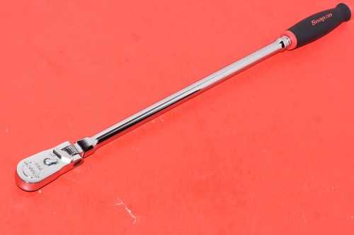

Just got my first ever long ratchet. 👍
It's the locking flex with the red ergo handle.
27" 1/2-inch drive.
This particular one has a pretty smooth and relatively-light lock lever. Not bad at all. I had to return a blue 18" 3/8 drive because I basically couldn't move the locking lever unless I used a tool. This 1/2"-drive's lever isn't bad. It could be better! But it isn't horrible.
Obviously loving the leverage of this monster.
The only OCD nitpick I have is the slight curve/bend in the shaft that's noticeable, but you kinda have to look for it. I bet most of you guys with the long ratchets have a slight curve as well; you probably just didn't even think to look for it.

VolvoRyan
Dec 29, 2019
1,339
Kentuckiana, USA
27" 1/2-inch drive.
Congrats! I went Snap-On for the 24". almost went Matco because I love my 3/8" Matco so much.
A 24" ratchet is wonderful for ergonomics alone.
-Ryan

I have AFR98LFG and CFR308LFG, in 1/4" and 1/2" drive, they see daily use. The super long 1/2" drive is awesome for alignments, which I do a lot of, and is pretty much the lengthiest one of it's kind as the others top out at 24". The heads are very slim and great for getting into tight spots. I have a fixed in 3/8", BFR118M. All 3 are the first ones I reach for, and I have what "normal" people would call a stupid amount of ratchets. I did have to get the super long one rebuilt as the direction lever was binding, and it's been good, if not better than when I got it.
