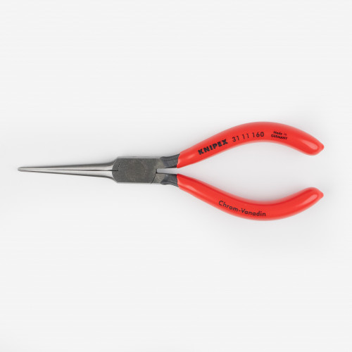

This is a Knipex version, but without the spring, and without serrations, and the tips are a bit wider and flatter.

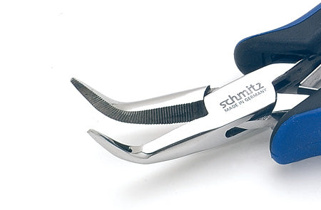

Schmitz from Germany might be another option,
I didn’t see tip width listed though.

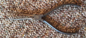

Well i think i solved the mystery! I believe they're the Utica 714-6 "Extra Long Needle Nose Plier"
After looking at tons of comparable pliers, I felt the closet matches were with vintage Utica pliers. The popular 777-6's were close, but not quite a perfect match. Thanks to the International Tool Catalog Library, I found an old Utica Catalog and discovered the 714-6.
The Utica "714-6" part number also tracks with the Matco "PM714P" part number.
Found a pic from a random listing online and can't seem to find any different other than the color of the grips.
Now I just need to setup some ebay alerts!
