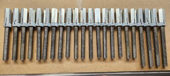

Alan I concure that a heavy separate slab has many "pros" and few "cons". I however am not a fan of untreated steel in cement [4140/(2) for "B7" is a great alloy]! They just don't play well together! (Rust issues), I would look for some M22/7/8" M19/¾" "J-bolts" for your application, or at least 1/8" (3mm) larger than the anchors supplied with your lift. I think larger is required as in a very quick search I couldn't find an alloy specification for hot dipped "J-bolts". Therefore added gerth should be mandated. Since you are adding a "base" undercut your existing slab considerably (4" min., 6"+ better). I prefere more smaller rebars in a staggered pattern even a couple on an acute angle from below. These are my thoughts [and only my thoughts, based on $#!+ I've seen and broke myself]. So this advise is worth what you paid for it, consulting a local professional is almost always a better plan! Use our shares to ask better/more/different questions. Harry
Harry,
Thanks for the comment. I soaked the B7 in purple power for several hours then scrub brushed it with dawn soap. The rod was red loctited into grade 5 coupling nuts and torques to 90ft lbs. Once I add nuts and a plate at the base of the rod, everything will receive red iron oxide primer. If any rod were to fail, it will be contained under the 3/8"x16"x26" steel plate. The holes in the plate are drilled to 11/16". The plate will have its own b7 J-bolts to hold it down. Maybe I will add a few 18-8 threaded rods to the plate for good measure. The only welding involved will be nuts on the bottom of the plate for the plates retention. There will be no welding on the coupling nuts, grade 5 full nuts used as jam nuts, or the 5/8-11 threaded rod.
I realize all steel will eventually fail in concrete. I feel the moisture levels should be very low since this is sheltered in the middle of a pole barn.
