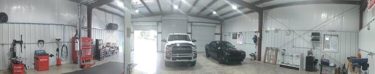

From what I read on GJ that cost is probably pretty fair nowadays. Make sure you get a several quotes, we did and the quotes varied by as much as 30%. We did not go with the cheapest we went with who answered our questions the best. Do your research and move at your own pace in deciding. Even though it has been discussed to ad nauseam here on GJ, it still amazes me how much building prices have risen since 2019. We had our 45*50*14 red iron shop finished in early 2019 for $45K. Including insulation and 7.5' finished metal interior walls, that cost also includes the 5" slab (6" where the lift is) with 20" footings 4000psi and rebar. Good luck in building your dream shop and keep us posted on your progress. Thanks for your service in the Navy as well. IMG_20211020_164354378[1].jpgIMG_20210119_121144097[1].jpgIMG_20210308_175054279[1].jpg
