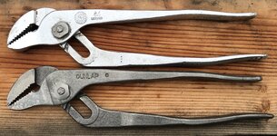

Over in the pliers discussion, @Private Lugnutz suggested that my pliers were McKaig-Hatch, the mark being MH rather than HW that I thought. So here are the 2 pair of pliers that I got in the same box lot at a sale, and looking at the marks while holding the pliers in operating position, one marking is upside down compared to the other.

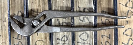

McKaig-Hatch #86 Arc Joint pliers. Just picked them up.

So each handle seems to have a number forged into it. Arguably 5145 and 8640, is that what you're seeing? Anyway, they could be something else S145 and 864D or whatever but if they are 5145 and 8640.....different steel alloys on the same pliers?
Ayrhead
Feb 23, 2020
571
Ontario
I’m thinking 5145 & 8840. Don’t know anything more about why the 2 numbers.
MR.X
Dec 13, 2010
1,811
OK, well "8840" wouldn't work with my alloy theory. BTW, there is a precedent for M-H ID'ing the alloy used.
30,784
Odd, for sure, but at least they're not on the same contiguous piece of steel, which would make no sense whatsoever.
It seems crazy, and could just be a matter of using old stock handles from two different batches, assembled together incongruously to each other. In other words, maybe there are M-H pliers out there with '8640' or '5145' on both handles.
Or, maybe these were both made with '8640' or '5145' handles originally and mixed up later.
Seems highly implausible, though.
What's intriguing is that on both sets of pliers, the handle made from AISI 8640 steel is the handle with the long arc-jointed slot in it and the handle made from AISI 5145 steel is the handle with just the pivot pin hole in it.
AISI 8640 is a triple alloy composition made with low doses of Nickel, Chromium, and Molybdenum invented as one of several "New Emergency" 86xx/87xx steels by a WPB-Industry consortium in late 1941 and early 1942.
AISI 5140 is a high content chromium steel that does not jibe with WPB WWII alloy restrictions.
I am suggesting - as complex, nerdy, and over-engineered as it may seem, that perhaps M-H deliberately made each handle out of a different steel composition due to the different respective purposes of each handle.

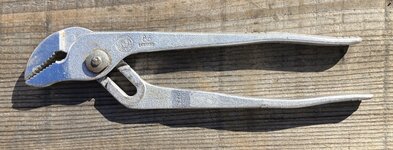

Here are mine with closeups of the forging marks. IMG_5013.jpegIMG_5015.jpegIMG_5014.jpegIMG_5016.jpegIMG_5017.jpeg
Not seen this handle grip pattern until Ayrhead’s above, now yours; same deeper/heavier transverse indexing/lines at the rear.
There a pair with more symmetry at:
Does anyone know if McKaig-Hatch named the pattern?
Have their pliers in our Model A tool kit; have to imagine they made them in house.

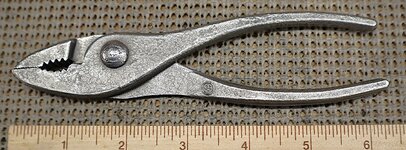

Way upthread I posted Model No. 438 8" slip-joints with the same M-H logo as the logo on the water pump pliers that @Ayrhead and @d42jeep have posted, but it has a completely different grip pattern...[ ]...Linked here.
...the grip pattern on my No. 438 slip joints is different than the grip pattern on the No. 86 arc-joints that Don and Ayrhead have posted, even though all three pliers share the same era monograph logo.
For comparison, here is the grip pattern again...

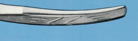

...and here is the rendering of the grip pattern in the 1954 catalog...
It's not exactly the same, but very similar, with stacked different length lines bracketing chevrons (three on the tool, two in the catalog image of the tool) in the middle. Not to put too fine of a point on it, but the grip pattern on my example of the slip-joint pliers and the grip pattern shown in the 1945 image of the slip-joint pliers are much more similar to each other than they are to the grip pattern on the arc-joint examples.
If you go into the catalog, it's obvious that they put the same grip pattern on the economy slip-joints and the thin-nose slip-joints.
Unfortunately, they don't show the grip pattern for the arc-joints.

As part of this discussion you might find it interesting to check out the Craftsman Circle Y thread.
Sears was buying from McKaig hatch as a supplier of Dunlap and Craftsman tools. IMG_8957.jpegIMG_8958.jpegIMG_8959.jpegIMG_8960.jpeg
Some Dunlap slip joint pliers with the same handle pattern.IMG_8962.jpegIMG_8961.jpeg

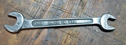

X, this is from the other thread, but putting it here. I see THIS 5/8 combo wrench that Gerald posted on Sep 24, 2024, but it has no 1555 P/N. Do you remember where he posted another example with the 1555 P/N? (Don't kill yourself finding it if you can't. @Mintgrun has a 1552 upthread here that also helps establish the heretofore undocumented Combo wrench series you (and then @four.cycle) sussed out on the other thread.)
// BREAK //
I am consolidating the wrenches from the other thread and discussion here, below, so we have all examples in one thread and the most appropriate thread for discussion.
30,784
Because I'm an engineer, a nerd, and because the entire universe can be captured in an xy matrix (as well a circle of 5ths, but that's a whole 'nother discussion...:)) and it was driving me crazy skipping around all over the place, I compiled some data on 'the numbers issue' for better visualization in one place and to facilitate further analysis and discussion.
McKaig-Hatch Analysis Worksheet
Tool*Verified P/NDerived P/NSuspected AISI NumberSuspected AISI NumberOwnerLoc
3/8" x 7/16" DOE Wrench17021046Private Lugnutzhttps://www.garagejournal.com/forum/threads/mckaig-hatch.339566/page-2#post-11420150
1/2" x 9/16" DOE Wrench1046AAhttp://alloy-artifacts.org/Photos/tools/mckaig_hatch_oe1618_wrench_1045_f_cropped_inset.jpg
1/4" Combination Wrench((1302))1549d42jeephttps://www.garagejournal.com/forum/threads/mckaig-hatch.339566/#post-9409492
3/8" Combination Wrench130415516152Stillgottimefor1
7/16" Combination Wrench130515521046Mintgrunhttps://www.garagejournal.com/forum/threads/mckaig-hatch.339566/#post-9650178
5/8" Combination Wrench13081555unknownGerald at Progress is fine blogspotTBD
7/8" Combination Wrench131215591045AAhttp://alloy-artifacts.org/Photos/t..._wrench_combo_panel_1045_f_cropped_inset2.jpg
Arc-Joint Pliers8686405145Ayrheadhttps://www.garagejournal.com/forum/threads/mckaig-hatch.339566/page-2#post-11403789
Arc-Joint Pliers8686405145d42jeephttps://www.garagejournal.com/forum/threads/mckaig-hatch.339566/page-2#post-11419506

(1) If there is no correlation between the numbers and left and right handles and they are just esoteric but insignificant die codes, it's entirely possible for pliers to have randomly come off the line with 8640 on both handles, with 5145 on both handles, or with 8640 on one handle and 5145 on the other.
(2) If there is no correlation between the numbers and left and right handles and the numbers represent different production runs (in time and sequence), it's entirely possible for a batch of pliers to randomly come off the line with handles bearing both numbers if they were using up all the 8640 stock before they were into using the 5145 units, or vice versa.
(3) If the numbers deliberately correspond to left (5145) and right (8640) handles, whether that's merely for assembly, or compositional (AISI)(and in my postulation, probably also mechanical), it implies contemporaneous parallel production, and you obviously need both handles to assemble the pliers.
If there are others, I am all ears!
Just to re-iterate and re-emphasize my opinion, in case I was being unclear or confusing...
/ I find the plausibility of these numbers not being AISI numbers (i.e., merely a coincidence that they match AISI numbers) extremely low.
/ I find the plausibility of M-H producing No. 86 arc-joint pliers with mixed AISI compositions because they were using up old surplus (e.g., from the 8640 wartime production era to the 5145 postwar production era, or prewar 5145 to wartime 8640), and Ayrhead and Don both just happening to find examples made in the same batch during this transitional overlap, low.
/ I find the plausibility of M-H producing No. 86 arc-joint pliers in two different quality classes or grades at the same time, one made of 5145 steel and the other made of 8640 steel, and some pliers being mixed up on the lines, to be not quite as low as the other two scenarios, but also not great, again, because there's not a top of the line and economy line difference between those two steels.
/ I think the idea of M-H deliberately making No. 86 arc-joint pliers with two different steels, one for the left handle and other for the right, to be very outlandish - as I prefaced when I first mentioned the idea, but heaven help me, I do have to admit I find this one more plausible than the others.
More examples and/or research may eventually make me eat crow, or watch someone else eat it. :)
