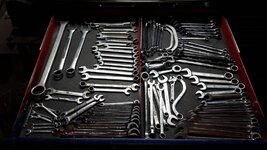

The SO rails (KRA15A) with wrenches in them measured about 1 1/2 at the highest point with a SO 19mm combo wrench. With a 7/8 RP Craftsman combo, it was around 1 5/8.
Here they are somewhat finalized I need one more set of rails for my extras.
The wrenches are pretty densely packed. In my case, that was entirely necessary since I didn't want any wrenches in another drawer (all my drawers are full). I think they do a pretty good job. If you are planning on going much over 21mm, you might be better off going with the KRA22A instead. Considering that more that more 100 wrenches fit inside one relatively small drawer that measures under 2", I think it's quite the victory.
Sent from my SM-G920V using Tapatalk

By the way, my drawer is just shy of 24" from front to back. I can measure the width in the morning if anyone wants me to. The largest wrench in the rail is probably the 7/8 RP Craftsman. I have a 21mm SO flare in there as well and neither have any clearance issues.
Also, a note on raised panel wrenches: My large C-man wrenches do not fit flush in the rails the way I have them configured (parallel). The RP section is of course thicker that the others so, unless the rails are set wide, those wrenches wouldn't seat completely. This isn't a problem for me, however, since I only have a few and will be replacing them with something decent soon enough.
