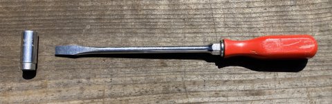

I know that tools stamped, "Mechanics Tool and Forge Co." can be as old as 1938, but were some tools stamped this way into the 60s?
The very long screwdriver in the thumbnails got me wondering about this. Note the odd stamping: there are two sets of "Mechanics Tool and Forge Co." and "Sabina O." One Mechanics Tool and Forge Co. stamp is almost completely off the edge of the ferrule. Was the ferrule sheet metal stamped as sheets before being formed?
