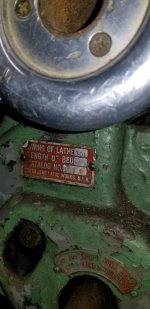

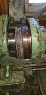

Well I looked at the lathe, sadly I am sure I am going to pass on it. The guy selling it got with the house he bought back in July 2019. It was no longer hooked up to power and could not since the previous owner had it hard wired into a breaker box. The guy selling it knew less than I did about it even before I started asking questions on here. This machine appears to have been bought from South Bend by the previous owner as some of the paper work was still with it.........but the previous owner definitely used this machine.......alot.
The Good
Its a 10L lathe.
The Bad
Its in an unconditioned shed where it appears to have spent its life.
I could not here it run.
The way had alot of wear on one side only (the back way) and mainly in the middle of the bed.
I tried testing the bed with the tailstock as described in the article that was posted earlier. It chattered and was hard to move after a short distance. Also the wrench and nut were worn hard.
The handle and dial for the tool post needs to be replaced as it does not work properly. I can pull the dial about 3/16" away as shown in the picture.
I hand spun the spindle and did not like what I heard. Sounds like a bearing is dry and grinding.
The Ugly

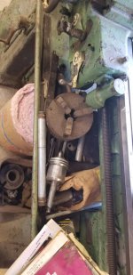

There were 2 3 jaw and 1 4 jaw chucks, the 3 jaw were hard to operate and the 4 jaw is frozen in time.
No other gears for it besides what was on the machine already.
And the really ugly.......after moving the carriage, I found a large chunk missing from the one way and what appears to be a ground out spot on the other way.

Honestly, that's not terrible. The dial on the hand wheels can be tightened, or replaced. There is a guy on Practical Machinist who can hook you up with dials.
The grinding marks on the bed ways are where they chucked up something large and it made contact with the ways. ******, but not a deal breaker.
The chucks have sat for a while and need to be disassembled, cleaned, then lubricated. I bet you could get them working again.
The spindle sounding crunchy is probably because the oil cups that lubricate the plain bearings in the spindle are empty. You need some lightweight oil in there (Mobile Vactra #10). Good news is they are easy to replace. Kits are sold online to get you back up and running.
I didn't read the article with the tailstock trick so I don't know what to say about that. You need to put some way oil (Mobil Vactra #2). That is what protects the ways and allows the moving parts to glide.
The carriage and gears all use a heavy turbine oil (Mobile DTE 24). Running it with no oil will cause problems and sound like it's all coming apart.
I bet there is over $750 worth of parts that come with that lathe, and more if you decided to part it out (Don't do that). That all said, I understand you are looking for a lathe that is turn key ready, and that ol SB isn't quite there (well... maybe?). If you are interested in a working project that would be a nice machine.
