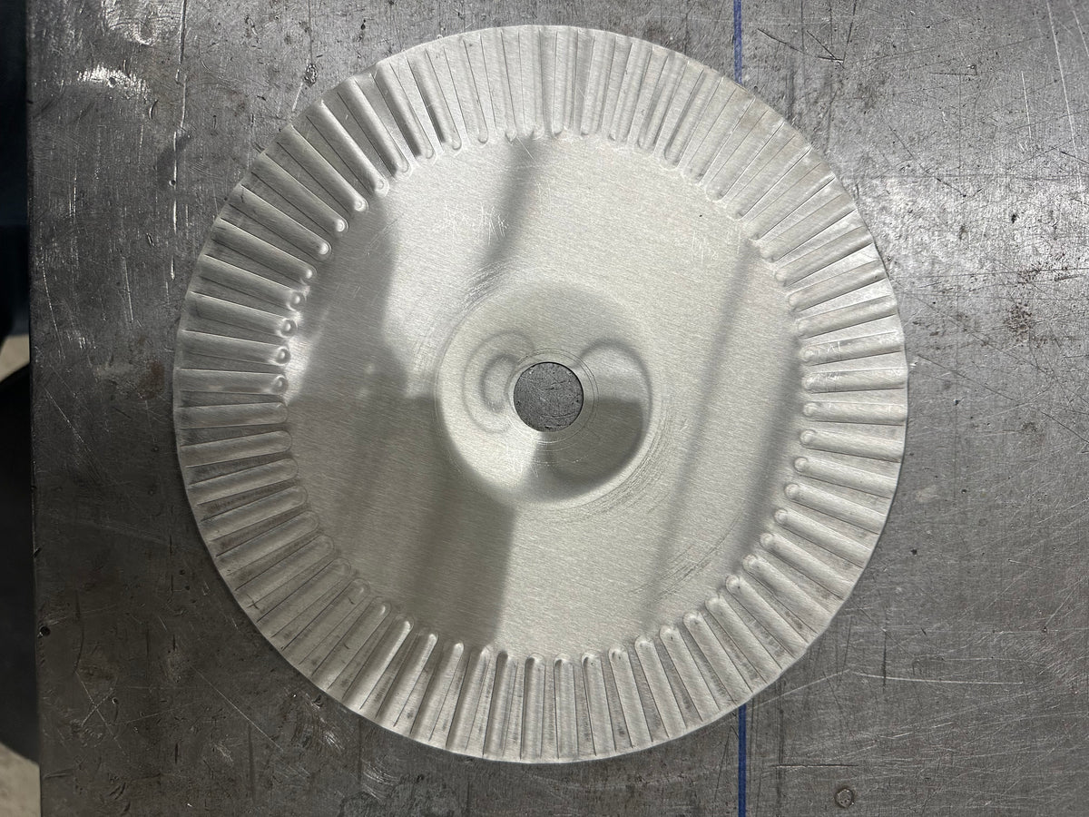

Has anyone ever used a metal shrinking wheel. It attaches to a angle grinder or sander .I purchased it from a outfit in California . Was wondering if anybody has had good experience using one and there opinion of it.

Useful if you do any metalshaping. Used to be some ok videos out there. More controllable than a flame. Is there something you want to know about them? They aren't really rocket science.

I'm getting ready to weld replacement wheel wells inner and outer . Just wanted to know if I get any warpage if this will work. I know it's not rocket science but after I use it should I douse it with water? Just looking for your guy experience using one and what kind of results . Fixing my wife's Dodge Ram 1500 4x4. Thanks in advance for any input.

I have used them to tighten up a "popping" spot on things like doors and hoods. But I don't know anything about them really, it rubs metal, metal gets hot, no more flexy spot. I wipe the spot with a wet rag after because I saw that on the interwebs.

The corrugated ones are incredibly loud, so double up the hearing protection.

Here's a picture & link to a shrinking disc.

I’ve got one of the pro shaper discs. Works well just make sure you have a grinder with enough rpms. Tried it with my Dewalt polisher when I first got it and it just didn’t spin fast enough to create the heat. It’s a great tool for when you get a bit carried away with planishing you welds and over stretch.
I personally don’t quench after use. Just let it cool on its own since water and raw steel aren’t a good mix. Oh, you can use scraps of bar soap to lube the disc so it doesn’t gall.

Generally speaking, if fit up is good, you won't be needing to shrink anything. The welds will shrink so you'll have to stretch them back out.

If you haven’t seen this, it’s a good outline of what a shrinking disc can do, but it won’t work miracles without some hammer and dolly work to go with it.

I think you need 6000 Rpm, on the waffled style disc. Some guys use a wet rag, or a spray bottle or a blast of air to cool down the base metal.

I love them.
I have two that get used regularly.
I would recommend practicing a little on some scrap metal to get a feel for it.
I use an air blast to quench.
Check out Wray Schelin on youtube. He makes it look too easy, but he's a master of these things.

Any “warpage” typically caused by welding is because the weld will shrink up as it cools, causing it to lose some of the length along the weld seam. This in turn causes an up and down wave to form in the adjacent area as the unaffected metal tries to deal with the shrinking along one edge.
You don’t fix this shrinking with more shrinking, that will only result in any outward crown of the panel pulling in, and any inward crown (valley) of the panel pulling outward, resulting in a loose panel (you’ve removed the shape) that will give you a loose oil can. You want to planish the weld as you go to stretch back out what has shrunk, using a hammer and dolly.
