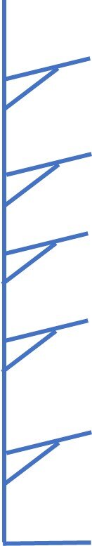

There is no reason for the whole thing to be one piece. 3-4 identical slender units with 5-6 shelves that are at most 12"
Something like this - size pieces as appropriate to what you put on them, bolt it to the wall and take most of the bending load out of the vertical part.
