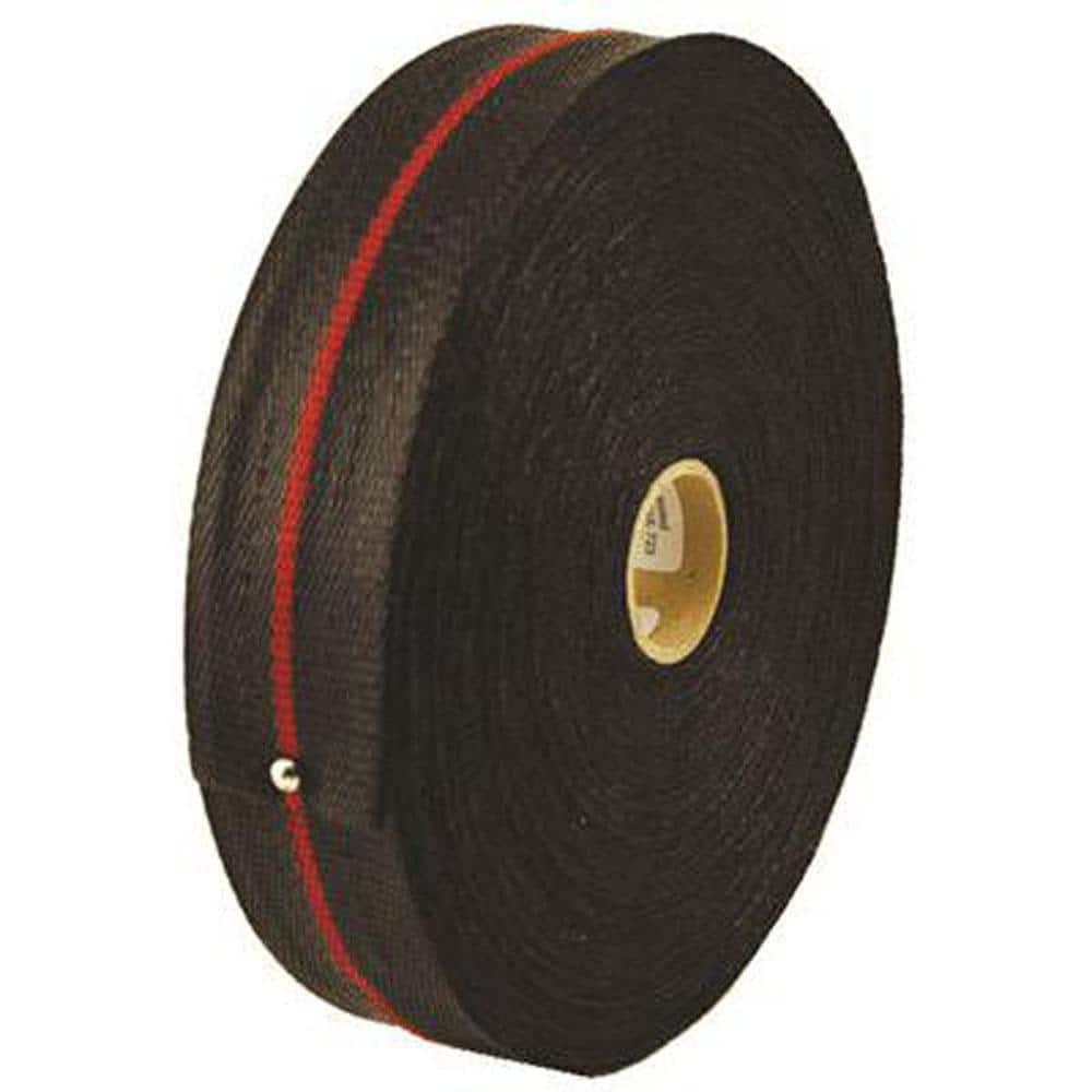

I want to mount a temporary baby gate between two brick columns on my porch.
I don't want to drill the brick and use screws or anchors because it's only going to be needed a couple months.
My idea is to mount the gate to 2x4s as a temporary door jamb and strap to 2x4s to the column on each side. A few of those big tie-wraps would be strong enough but they would have to be like 6 feet long. Ratchet straps would work but be "too ugly". The perfect thing would be metal banding like they hold lumber to pallets with but I don't know where you get that or how you tighten it does anyone sell single use metal straps or cable?

The metal banding takes special tools for tightening and crimping the stay. I’d suggest some 1/2 or 3/4” wide by 1/8” flat bar and bend it to wrap the column then screw to the 2x.

You can get HVAC zip ties 36" and 48" long on Amazon. Use two to get the length you need.
Wire rope and turnbuckles, but probably overkill for a baby gate.
Large side forces could be a problem, the 2x4 may slip sideways on the face of the column. If you pin the 2x4 to the column with a couple of 1/4" anchors that shouldn't happen and is easily repairable if you drill into the mortar joint.

If it were me, I would probably think along the lines of a combination of 2x4's or plywood to make sort of a U shape for each side that would sit vertically on the column but also wrap an inch or two around both sides of the brick instead of it sitting entirely on one face of each column. That way, any attachment mechanism you use to wrap around the column doesn't have to be super tight for everything to stay in place and work correctly. It also prevents the gate from tilting on you or failing as easily if force is applied to it horizontally like would happen if a child or dog ran into it while closed.

You can get rolls of metal strapping with holes in the plumbing dept. Used for hanging pipes.

Any place that sells to concrete contractors will have metal strapping with holes punched every inch or so. It's used a lot in forming concrete. Wrap it around the post, making tight 90bends at each corner, cut to length, make 90deg bends in both ends so that the resulting legs are a couple of inches apart. Now a long screw through a hole in each end leg to tighten.

Look for strapping kits used to strap TV antennas to a chimney. If you fabricate brackets to fit over a corner, it will be more stable than flat against the face of the column.

If you want to go the band route I would recommend a product called Deltec. Its a plastic band that comes on a roll and can be cut to any length easily and tensioned by grabbing and rolling your pliers then you can tuck the end or cut it off clean. Steel band is doable but I wouldn’t use it on square columns as it tends to chew up the corners. Look at bolt-a-band

This is what JBFSR is referring to:
If you prefer metal, use this:
Prefer a synthetic, use this:
