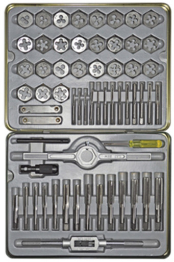

This is the set I have that covers both SAE and metric. Has 27 taps and 27 dies and is made in Japan. There are other kits also. I put it on par with Hanson. These are the same taps and dies sold under the Century Drill brand in various kits but are cheaper under the Alfa Tools (depending where they are sold) brand. I think it's good value for the price of $ 121.20 from this vendor. Also, you might see what they offer in a metric only set since that's what you are looking for.

See if you can find an old craftsman set. Good taps.
Recommend the Lang/Snapon/Craftsman rethreading kit
X2 on the old craftsman set. Both of mine are from the 70’s
I finally had to make a new box for the std. set. Taps lasted longer than the plastic box.
My set from work. Various brands obtained from the stock room. All quality. 4-40 thru 3/4-16
These were used a lot for fixture building. Almost never needed a die.
IMO Starrett tap handles make a real difference if you use taps very much
