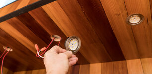

We've seen the light!
I considered doing LED strips but decided that puck lights, and the small pools that they create, were the better solution. I got them from SuperbrightLED and I have no affiliation but they seem to have what I need usually.
We hot wired one of the lights and also put small circles of tape up to judge placement. You'd think you should just center them up but straight top light is not very flattering so we tried 7" from the front since the depth is 21" but that felt too far forward. We pushed it back to 8" because it felt right. We also pulled the side lights in a bit towards the middle - only an 1-1/2" from the middle but again, it felt right.
I was a bit nervous to drill the holes but after triple checking my measurements and taping the spot to reduce tearout I just went for it.
Since Lara has worked as a marine biologist and with the non-profit fishing organization Fish Florida she was obviously tasked with the job of fishing the wires out of the holes. She proved her worth.
The nice part of wiring up LED's is that they're low voltage and you don't have to take any special precautions like you would with 120v household current. Still, we use the right size wire nuts.
There's no "i" in team work. No "z" or "q" for that matter. Just sayin.

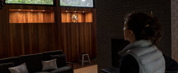

I used a transformer that plays nice with triac dimmers which are probably the ones you have in your house. Triac dimmers are for normal lights. LED's have a hard time dimming so they tend to flicker. A power supply that's designed for a Triac dimmer let's the light go low without the flicker.
Plug it in and test it out before we stuff them all up there and... it works! Yup, still amazed when electricity works first time. It's like I'm a hundred years old or something.
Then, for the full effect, we kill the other lights and admire our handiwork. It's pretty cool and feels like a neat period detail. I'll have to start shipping back my nicest fans to put on display now.
