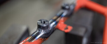

The only change I made to the subframe, additively, was some offset tapped mounts for the new low mount titanium exhaust. I'd already cut off the luggage racks so I'd accidentally cut off half of the mount anyway. This will be slicker and I'll get to make my first titanium part - an exhaust hanger. Small, low consequence and a good use of material.
I called about 10 plating places and all of them had a 12 to 20 week lead time. Finally I found a place in Vancouver that said they could do it for me in two weeks - with a rush charge. Okay, but the frame needed to be stripped. I found a local place that stripped the powder chemically instead of burning it off and they turned it around in a weekend.
It is nasty process but also a very cool one. And the place was pretty dramatic.
All the way to bare steel.
I welded some small braces to the headlight mount which has failed in some situations. Probably not needed given the stout mount from Aurora, but it's a belt and suspenders deal.
The right way to do this would be to mock up the bike with the stripped frame and see what else can be stripped or cut off. The steering lock, the small mount for the electronics on the headstock. But I'm just going to accept it.
I dropped the frame at the platers right before I got my flight. I'd ordered wheels and a seat and so I was hoping that when I came back in a week I'd have parts.
Wheels showed up - Dubya turned them around super fast. On Monday, Tuesday, Wednesday I called the plater getting more nervous each day as they never answered and their voicemail was full. On Thursday I drove out there and my frame was done but in chrome, not nickel. They apologized for the mistake and said come back in two hours.
Two hours later...
This is going to be out there - different. They did a great job on the plating. It's up to me now.

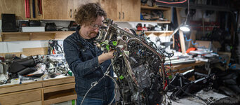

Yesterday I called Ben. I knew I was going to need physical help to get the frame onto the motor but more importantly I needed emotional support. While most of the wires can only go one place the routing has to be perfect.
We cleaned the engine and swingarm with Scrubbing Bubbles, water and a paint brush and then finished with some Pledge. Because Pledge. Scrubbling bubbles is now my other favorite cleaner.
With the motor on the lift we threaded the frame on to the top of the engine and pulled the various connectors through the openings. It's a super tight fit and while I'd done a fair job with the fasteners in bags there were still questions.
I found all the photos I'd taken while we took the bike apart, printed them out and taped them to the cabinets and we referred to them to route the harness back into place. Between the photos, the wire memory and the zip tie anchors we got most of it into place. Way more than I expected. My big fear is getting the bike together and finding a wire that is outside or inside and the only way to fix it is to take the frame off. I think we're good.
While the bags seemed very organized there were still some fasteners that got mixed up and we puzzled it out with the photos, the shop manual and a bit of common sense. As an old friend used to say, "It only goes back together one way..." and that's mostly true.
With the harness in place I wanted to have Ben help me get the forks and swingarm on before he left. Mentally, having a rolling chassis is the key to getting the bike back together. Physically it was going to be hard to do on my own but if you can get the frame up on wheels it becomes a motorcycle instead of a sprawling collection of parts. I needed a win to get my enthusiasm back.

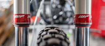

A big part of that is putting on the new suspension which is very special. This is actual factory rally suspension - 300mm or 12" of travel. I was offered the choice of standard or the rally and I did not hesitate getting the longer legs. Getting this took pulling some "inside the industry" favor's - this is the only set that came to the USA this year.
Anodized accessories can end up looking like costume jewelry - tacky - but if you're careful and they have purpose it's a detail that works. The tiny bit of red on the suspension is a nice accent. The big open tube above the shock normally has a black plastic cap but I'm going to make some aluminum caps that match the shock knobs.

I spent a day or so going over the wiring, cleaning and checking connections and then figuring out what to work on next. Usually I like to save the exhaust for last because it's one of the more fun parts but in this case the headers needed to go on before I could button up the front.

Since I cut off all the luggage mounts, tabs etc on the subframe I knew I needed to have a mount for the exhaust so when I welded the bungs to the subframe it was just an educated guess since the bike was apart. I'm pretty good at educated guesses, I guess, because the placement was spot on. There's a fair bit of movement in the exhaust meaning I can raise or lower it by maybe 10-12cm (3-4") and also move it in or out. My plan for the moment is to keep it pretty close to parallel to the subframe but a closing angle may work better. I'm going to sit with that for a while before I decide because it's a very important thing to get right in terms of the overall look.
[IMG]
