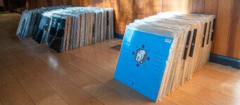

I brought the records in from the cottage. Nadia, Lucas and I took a month to alphabetize them again. We stopped streaming music and started to play records. Nadia invented a game: pick a letter and a number. F 22 = Fine Young Canibals, J 11 = Jefferson Airplane, R 33 Roxy Music.
We've stopped watching TV and spend our evenings playing music, drawing or playing games. It has been single greatest thing that has happened in this past year - I have music back in my life. Not as a background while I work but as an active thing that I'm curious about and that I share with Nadia who is far more into the music than Lucas is right now.
The records took over the house for a while this fall as they were alphabetized they eventually found a home in the china cabinet - which is now the record cabinet. But the shelves were sagging because records are heavy.
I found just enough birch ply in the scrap to make some dividers that I screwed to the shelves.

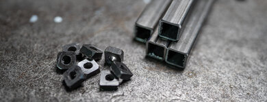

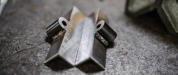

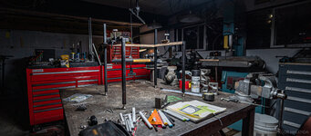

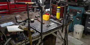

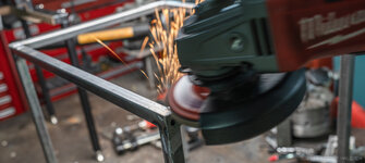

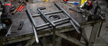

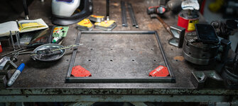

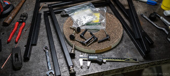

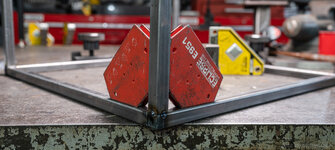

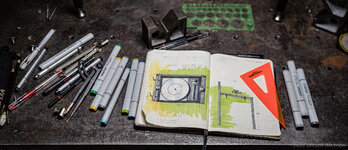

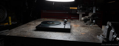

Because I can't leave well enough alone and because I wanted to do some updates to the Linn I needed to make a jig. Could you tune up the turntable without the jig?
Sure, but it would be not very optimal. You need access to the bottom.

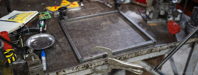

The factory jig is a stand that clamps the turntable at the edges and has a pair of uprights that allow the jig to be laid on it's back to make working on the table easier vertically but the main job is to hold it level with the bottom open to adjust the suspension. The factory jigs come up for sale very infrequently and are expensive so building one seems like a good way to warm up in the shop.

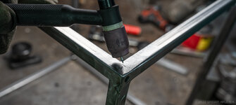

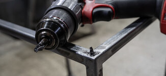

It starts with a sketch and some tube. I wasn't sure what size they used but I was pretty sure it was 1" or 25mm and I wanted to try smaller tube as I want to build a stand for the turntable too. I bought 3/4" and 1/2" and decided for the 3/4 for the jig.

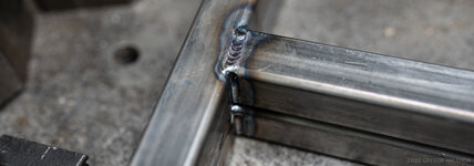

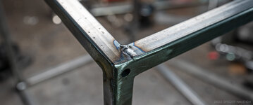

First welds back are pretty good...
The Linn jig uses philips screws to hold it together. I could have just welded the whole thing together but the original is screwed together to make it easier to ship and I choose to make mine break down to make it easier to store. I will use this only a few times but it's nice to have. So I break out my quick adjust knobs - a collection I have from trying to modify photo gear over the years.
I could have bought inserts but it was Friday. Standard square nuts can fit the 3/4 tube perfectly but are standard and I like to keep projects metric or standard and if it's related to something European I'll try to be sure it's all metric. So had some 3/4 bar stock and drilled and tapped...
...and then just fusion weld the seam with a fast pulse setting. I could dress the welds but I'm not going to bother. When I make the turntable stand - the one that will live in the living room - I'll dress those welds.
That is the bulk of the welding so I put it together and do a quick test fit.
I've been measuring and re-measuring because the lip that the turntable rests on is only about 5mm on each side so this needs to be accurate but not too tight.
So you can see it rests on that thin lip and the measurements are all good. Time for paint.

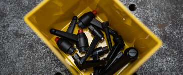

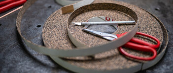

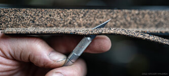

The basic table is painted and the feet and cork from McMaster has arrived. I could have made feet but these have nice rubber bases and are M8 metric.
The thing I love about ordering from McMaster as compared to Amazon is that McMaster always surprises you with better quality than you expect. This cork has rubber in it making it a little sticky and less likely to slip. Nice.
I ordered 3/4" so it would match the tube but the edge clamps are narrower and need trimming.
So the base is done, corked and trimmed. I still need to make some clamping device. Linn uses these disks with wing nuts on the bottom that are... less than I'd expect from them. Since I'm all in at this point I'll make something better.

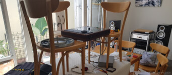

That's not me. It's a photo I found of one of the more precarious ways that people try to support the turntable. Gives me the creeps seeing that.

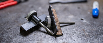

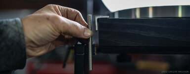

With the turntable in place I dig through the scrap and find some 1" angle iron that will make a good clamp. The angle to where the bolt will be has a bit of a gap and my first thought was to just weld the threaded rod onto the angle but...
...I decide to make a stand off and then use an insert so it's not fiddly but they need the right amount of offset so I'll mill a flat onto them. This way they'll be aligned.
I had a friend visiting so she was able to snap some photos while I worked so you can see both my scratched up hands.
I was thinking of trying to weld all this with bronze but decided to just use steel filler to make it easy.
So here are the brackets. I milled and ground them flat so the pressure would be even.
I ended up using a threaded insert on the base as I didn't drill the holes through for the clamp because I just didn't like that idea. Felt like it should be neater and cleaner.

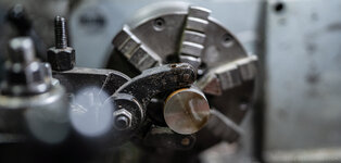

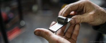

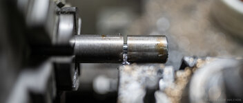

And since I was using stainless all thread I decided to make some stainless knobs. Knurling stainless is pretty hard as you need a crazy amount of pressure but I seem to get lucky with a slow speed and fast feed and just crush it until it repeats and you get a clean knurl.
The knurls aren't perfect diamonds but they're close enough and have a LOT of grip. I drilled and tapped them and then welded the threaded rods with the intent of machining that clean again. Chamfers on knurls keep things neat.
So I'm very happy with the clamps. I think since this blog started you've seen me evolve over the last 10 years to be a much better machinist and fabricator. It's been interesting to see this evolution unfold and every once in a while I have to take a moment and appreciate that I've improved. All the fits are perfect, the bolts line up, the holes line up and the table is square and straight. I wasn't being super careful but my "feel" is better.

And that is that. Next thing to do is to get the turntable mounted and taken apart and do the updates. I think before I do that I might make the stand for the turntable - the one that it will live on permanently. The world of hifi is goofy and mercurial and I feel like it changes all the time much like health advice. When I was involved you wanted to create very rigid structures to allow the sound to be accurate and now there's a trend to decouple. Decoupling at the source makes sense but at the speakers doesn't.
I'm going to build a sturdy base or platform and the turntable has rubber feet so who knows. I'll listen to the differences and see what I think. For now it sounds amazing so hopefully the updates will just be more of the same.
The sketch at the beginning was very basic and in pencil. As I build, especially something like this where I'm not sure exactly what all the solutions are going to be, I make changes in the drawing. As I weld and lock things in I go back to the sketch and start playing with it, locking in the sketch with pen while waiting for paint to dry. I just love drawing so it's another way for me to relax, clear my head and think.

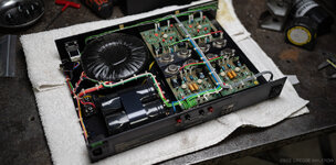

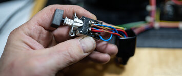

With the feet off and a five screws the amp comes apart easily.
And this is why I love Naim so much. Inside, where no one sees, they dress the loom to make it beautiful. It's probably where I fell in love with the idea of making details perfect that no one would ever see. To me this was an easter egg before there were computer easter eggs.
Since Naim wasn't going to build for just the European market they built their transformers to use 240v or 120v depending on whether they were wired in series or parallel. I had to ask because I'd forgotten exactly how but inside this neat loom is a secret.
The wires inside this bit of shrink wrap are soldered together for 240v operation...
...desolder them...
...and solder them separately to the other leads from the transformer and you've converted a 240v amp to 120v.
I didn't have white zip ties. Or enough black ones to replace all the rest. I hope you aren't disappointed. I know you are. That's okay.
The last detail is you need to change the fuse from 4amps to 8amps (which is even explained on the back of the amp)
Same goes for this Hicap but the wires are a little different. Same beautiful attention to detail inside however.
It's interesting that they actually go out of their way to bury the spliced wires inside the middle of the loom so that they are completely hidden.
I was warned that you need to be fast with the soldering iron because, evidently, the switches are unobtanium now with this gear nearing 20 years old. Much like my motorcycles I like having the very best - 20 to 50 years after the fact when I can afford it.
Again with the black zip ties.
Naim will do this mod for you but at a cost of $295 per unit.

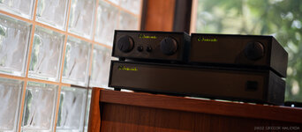

The temporary placement of the gear on the credenza will need to be resolved because it was never meant for that sort of weight and it's sagging. So I'm going to build something for the gear but I want it to be interesting and functional and I haven't resolved that yet.
But next up I'm going to build a stand for the turntable. Simple, light and delicate.

I ran an end mill over them as a group to get them all the same 444mm which is the exact size of the OD of the LP-12. My plan is to make a perfect square of the width of the turntable and match the depth as well so it's a perfect match. If you're going to build a custom table you might as well make it custom.
Instead of drilling these individually like I did with the work jig I drilled the bar stock first on the lathe and then cut them out. I decided to not tap them until it was built so welding wouldn't put stress into them and I'd have to chase them anyway. So these are the uprights of the square tapped into the ends and fusion welded.
I subtracted 16mm x 2 from 444 and cut the cross pieces. It's funny that when I started welding my biggest challenge was to not burn the **** out of the material. I had a led foot on the pedal. Now my challenge is to equally distribute the heat to control the warping.
Measuring diagonals is how you can tell if your square is square. This is less than 1mm out right now - yay!
Of course as I stitch and flip and balance heat I get a warp in the third dimension. Clamps and vise-grips and trying to weld where the heat will contract it back to flat seemed to do the trick. The other part of that is trusting your heat will balance the equation.
Because I want this to look clean I'm grinding the welds and also I'm grinding them because I need to now weld the vertical parts of the box.
These little magnets have paid for themselves many times over. I prefer the ones you can turn on and off (background) but these are narrower and work better for this tube. Small tacks in the middle of the tube to keep it from pulling.
A box seems simple until you try to weld one. Then you realize how many ways it can go pear shaped instead of square shaped.
Now all the "depth" sections are tacked into the front (or back) of the box.
For the most part it lined up. One arm needed a small amount of persuasion to meet up but since it's all tacks at this point that wasn't too hard. From here I am measuring the other diagonals to make sure I don't end up with a parallelogram table. I had to do a small squeeze with a clamp to bring in one side about 2-3mm but for the most part I was pretty good. I would weld a seam, spin the table and weld the opposite one and then flip it and weld the other side and just kept repeating that until...
I got to the inside corners which I left to last thinking that they'd pull but if the rest was locked in it would be mitigated. That seems to have worked.
I tried to make sure my welds were proud (I wasn't...) so I'd have material to grind flat.
Then I'd use my favorite grinder - my Milwaukee cordless - and an 80 grit flap wheel to flatten the welds.
Despite best efforts there were some small spots that were missed and I went back over them (with a better point on my tungsten I swear to you) and put a bit more filler in them.
Then I broke out the Festool Orbital and dressed the corners to match the rounded edges of the tubing. The goal is to make the box look like a factory offering but more burly. The inside fillet tig welds are something you probably wouldn't see but I tried to make them small enough to match the curve of the tubing but in reverse.
The last step was to tap the holes to M8...
...and wouldn't you know it! My favorite drill/tap broke on the very last one. I wasn't using tapping fluid (after the first hole) as I didn't want to get the tubes greasy before paint. Ah, corner cutting, it always has a cost. I got very lucky and was able to back this out with vise grips.
