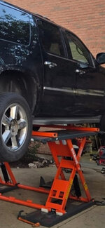

If this helps explain what I’m looking for I found this picture of a Stratus SAE-MS9000XT with a full size Chevy Suburban which I believe is all of 6000 lbs.
I would much prefer seeing a video of it lifting the Suburban rather than a still picture.

I have that exact lift from Stratus. Bought it in 2022. Bought the support bars with it. It has lifted my 2016 F250 6.2l gas, extended cab, short bed, 4x4. It weighed right at 7000lbs with a full tank of gas on the scales at the quarry. It didn't have any issues doing it. I don't know if the ramps are long enough to do a crew cab though.
