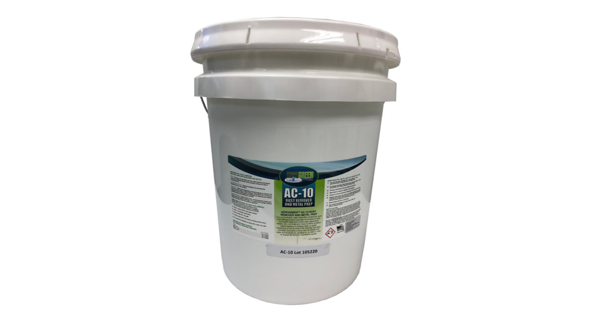

No doubt mark-NJ, it's not exactly cost effective if your projects aren't the type you derive income from.
I have good luck with the paint prep discs, and if the parts fit in my blasting cabinet they get blasted to remove any residual that the discs don't get.
slowtwitch73
Apr 18, 2019
5,876
Hellgate
Yeah, sorry about that.. I didn't see the prices till later.
I used the stuff a number of years ago before they sold direct, and it was not that expensive. I checked the web to see if it was still around and posted it without noticing prices.... my bad!
It does work like the clappers.
