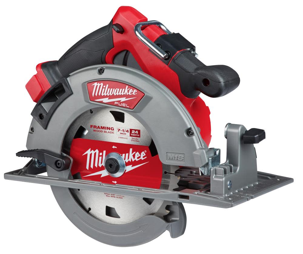

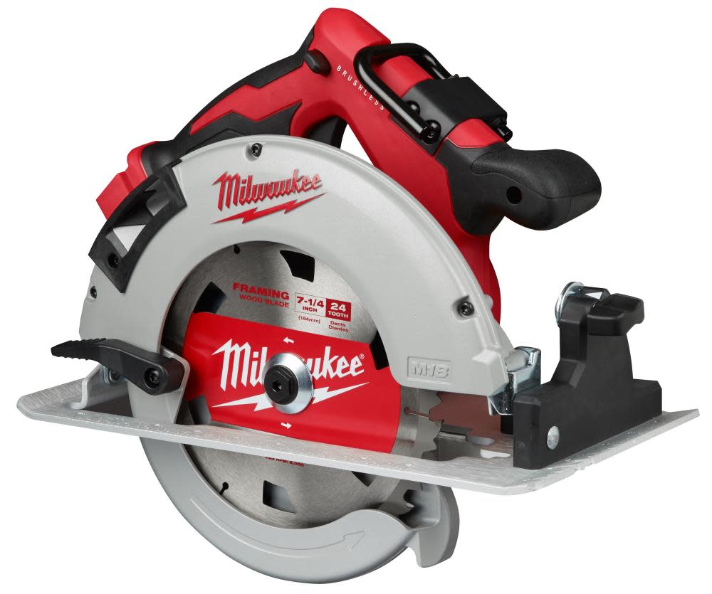

Wanting to get the Milwaukee 7 1/4 circular saw sidewinder. It’s an M18 saw but I also found out that there is one that’s called their Fuel 18 volt. The Fuel 18 volt 7 1/4 is also brushless but cost by itself is at 249.00
There is also another saw that is an 18 volt Lithium saw that includes saw, battery,charger for 279.00 which both is at HD. But my question is that I thought that it was battery that made the saws different. Is there differences between two, which researching the batteries can get kinda expensive. What saw would you go for if both are brushless, should invest in better battery?

absolutely only buy the FUEL, I love mine.
Also- a lot of guy buy the giant packs and sell off their duplicates. I got a BRAND NEW Drill, Impact, 7 1/4 circular saw and two 5.0 batteries for $450 off FB

Between all the basic battery tools that most people have, I can’t think of one that I appreciate the power more than in a circular saw.
Bigger battery also has more power because it can pull a higher running load from more cells.
Bigger battery is also heavier though. It’s nice to have multiple sizes. Use the small batteries on like the impact driver micro drill, use the big batteries on the hammer drills, saws, sanders, etc.
A circular saw is about the only tool I own in battery and occasionally still use corded because of the power. Wish I had one powerful enough that it didn’t matter much.

I think the only complaint I've heard about the fuel is its size and weight gain over non fuel. But I can't confirm what that difference is as I have never used any of their circular saws.
jeepxj
Mar 2, 2008
17,972
now ya got me curious:
fuel: 10lbs
Fuel: 8lbs:
non fuel: 7.2lbs
non fuel: 7.2

I have the front handle fuel. I've been using it to build a boat and using it for a lot of scarfs (full depth blade cut) and curved cuts. With a normal 5.0 batteries it's worthless and wouldn't make a 30" scarf cut without changing batteries. Put a 8.0 on it and it's been a great saw. It's been the only circular saw I've used on the boat from about the 4th day on when I decided my corded Ryobi wasn't up to the task. Sharp blades are very important along with big batteries. If you don't want to buy a 8.0 battery I would just buy a corded saw.

High draw tools like a circ saw should only be FUEL
Big batteries are also a must
Anything less usually results in starting a new thread "battery tools arent up to the task"

In general, aren’t the non Fuel Milwaukee tools all brushed, while the more upscale tools are brushless?
The non Fuel are mostly legacy platforms with cheaper components, ie stamped instead of cast aluminum shoes, cheaper chucks on drills. The non Fuel tools are generally advertised heavily and sold at low prices during holiday sales events.

Guys thanks so much, Fuel M 18 it is at 249.00, and a spider saw blade. Now this leads me to one more question, which is the battery guessing bigger is better. Not knowing anything about Milwaukee batteries, what size and who has best prices? This is a saw that I plan to do pre cutting the 2x6's here where I live then haul the lumber that I can use for day and do the framing. With Memorial Day coming up maybe something will go on sale? Thanks guys for the guidance on saw selection and battery selection

Milwaukee is very "proud" of their batteries ! You can get away with a 3.0 or 4.0 if you have a spare and can recharge the one you just used up. If no charging is available at the site, you will need TWO 5.0 batteries. Many guys have a small inverter in their truck just to run the charger.
EDIT : I just noticed, Milwaukee makes a charger that plugs into a 12VDC out. Does both M12 and M18.

You NEED to run a 8.0 or bigger on it or you will get frustrated with it quickly. You will be very disappointed with this saw if you try and run 5.0 batteries on it. Bind the blade once or twice and the 5.0 or smaller battery will go to nothing in a hurry. With a 5.0 you have to treat it very delicately, with a 8.0 treat it like a normal corded circular saw. I get a couple days of boat building out of the 12.0 though am not making 200 cuts in a 2x6 though many times am making 40'+ of cuts in 3/8" or 1/2" plywood.
Edit: 8.0 not 12.0

I believe it's cheaper than buying 2 batteries and a charger along with the bare tool. The other option would be buying the saw with a 12.0 battery for $450 though a second big battery is $200-$250. There's a lot of ways to slice it. Sometimes it's cheaper to buy a tool for the batteries than buy batteries and a charger. My 8.0 came from a leaf blower and battery combo, I also bought a m18 fan and when we run it up it was cheaper with the fan on promotion than just buying the leaf blower

I have the original fuel 7 1/4 and its been awesome. I cut all the wood for my house including ripping all the 5/8 osb for the roof deck, stacked 3 sheets at a time, with no issues. The day we put the roof on, we did the rafter tails, all the cross bracing, and the osb with one recharge during lunch of the 9.0 amp battery.
I have also done stair stringers without issue. After doing them I cut down to length a bunch of 2x4's. I had two more when my battery 9.0 bat died. I finished the last 2 2x4 with a 5.0 bat. It had less power power with the fresh 5.0 than the last cut on the 9.0
At work they have a non fuel 7 1/4 m18 saw. If I hadn't of used the fuel version I might have been ok with it but for the simple sheet of 1/2' acx ply I was not impressed.

The fuel saw is pretty nice with the 6.0 a hr batteries. I hogged through a pile of 6x6 timbers then slapped the battery the sawzall to finish them off with plenty to spare the other day.
As far as fuel versus non fuel. There is no such thing as a circular saw with too much power, only saws that piss you off less than others.

I have the M18 Fuel saw. It’s fantastic.
I am happy with mine. It was a free 8.0 ah batt. deal.
I moved from a basic corded that got dropped and cracked.
I wish the 7 1/4 Fuel saw had been in a giant tool pack. Everything was 6.5. Maybe that's changed.
You can get some work done with an 8. Minor stuff, it will cut with a 5 but won't power through long jobs like an 8.

In general, I always reach for the smallest battery that will do the job at hand.
You don’t get extra macho points for spending money on a battery larger than necessary, and the large batteries are bulky and heavy.
I would go with a couple of batteries in the 6 amp hr range. They Often go on sale in a two pack, if I recall. Repetitive cuts in wet treated lumber may make me rethink, though.
