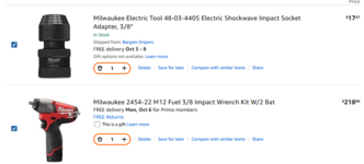

I’m considering purchasing my first battery powered impact driver. Brief shopping led me to this one:
Advertising boasts 2000 in-lb (167 ft-lb) of torque! The quick release collet style tool holder requires a 1/4” hex shank tool. For nuts and bolts, I’m considering using these socket adapters:
Milwaukee advertises these adapters as being made from a proprietary alloy and heat treating. The interchangeability from socket drivers to screw drivers and whatever else with 1/4” hex drive is desirable. However I have to ask, 167 ft-lb of torque through 1/4” hex is a lot! Does anyone have experience doing this? Does the 1/4” shank hold up or shear off at full power?

Ok for household use, but you lose a lot of torque capability through those adapters, so it’s pretty weak for removing real structural nuts and bolts in, say, automotive repair.
I would recommend something with a 3/8” square drive at least for general use. Drivers like the one shown are great for light assemble, using torx screws, or dedicated bits. Not a fan of those adapters, though.
You’re going to struggle removing lug nuts, etc.

I use those impact adapters for 1/4 sockets all the time. That tool will be great for that and driving screws.
As mentioned, a 3/8 drive will be much better for anything bigger than about 10mm.

They have an M12 3/8" drive impact with 500 ft lbs that is a beast. Light, compact and stupid powerful.... Get it and ditch the hex to socket adapters

You need a 3/8 impact. You control the speed with your finger, and they have settings to limit the maximum torque.
You say you are "checking tightness of nuts and bolts"....I would want a hand-held ratchet for that.

The Milwaukee M12 2454 3/8" impact has 2 power settings.

I use a 3/8" to 1/4" square adapter with my M12 2454 when needed.
I did have to buy an M18 1/2" mid-toque for wheel lug nuts !

It's the wrong tool for nuts and bolts, you really want a square drive impact wrench

I'm shocked it took this long for someone to point this out. The name kinda says it all. Impact drivers are essentially souped up screwdrivers. Impact wrenches are souped up socket wrenches.
You need the right tool for the job.
