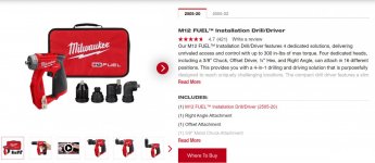

I liked the M12 installation kit so much, I bough a second one. I also really like the 'surge' hydraulic driver and inflator, although it is very noisy, really comes in handy.
