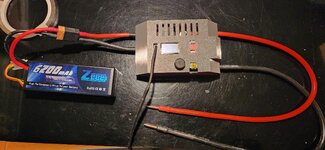

I wouldn't just get rid of them immediately. If you're lucky it may just be a bank of more of cells that are unbalanced. That happened to me last year, rebalanced them & they have been working fine since. A coulpe of them are from 2015 also. Yes cells do go bad but it's not uncommon for a bank of cells to get unbalanced in a pack.
