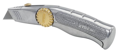

I was happy with my Milwaukee 48-22-1910 Slide-Out Utility Knife until this happened the other day:
I was using it to slice into the sidewall of a tire so I could get get my sawzall started on removing the tire bead. I finished the slice with my $2 Harbor Freight utility knife without an issue.
So, do you think I was expecting too much from the Milwaukee knife? Was I "misusing" it? Did it get made with a bad batch of metal? Or, is it just made of cheap metal?

I returned the broken Milwaukee to Home Depot without issue and I got the DeWalt DWHT10035L Folding Retractable Utility Knife which was the same price. I liked it except for one major flaw - the little black release button worked fine when releasing a blade, but when it came time to insert a blade, it only inserted easily about 1/4 of the time. The other times I had to either force it, jiggle it, or press the little black button harder than should be necessary.
Apparently I'm not the only one who has had this issue as is noted in one of the responses to a review of it:
Review: DeWalt’s Folding Retractable Utility Knife
I returned it to Home Depot and was done with these "improved" utility knifes until I saw this at costco for $9.99:
The Stanely Instant Change had the two main features I was looking for:
1. On-board easy access blade storage
2. Quick blade change
So I bought it and not only did everything work on it, I was able to cut the entire sidewalls on my two tires so I didn't even need to break out the sawzall. The sturdiness of the knife allows you to put a lot of pressure on it. I wish the blade slide was on the side like the Milwaukee, but that's a minor wish.
In the case of the Milwaukee and DeWalt it seems that in favor of their "innovation", they have overlooked quality control.
-Bp

Bruce Lancaster
Apr 3, 2006
1,642
That picture shows why I like my ancient Stanley USA cast-iron utility knife...if I pushed too hard, my arm would break before the knife body. No convenience features but also no potmetal and no huge gap in the structure...

The Milwaukee is I think more poor design than poor material. A full-handled potmetal knife has always seemed adequately strong, though I continue to strongly prefer my good old iron one. The problem is that it has only a thin backbone with no structure on the other side of the notch for the fancy mechanism. If it had a metal belly there it would be adequate...with that open and unsupported, the handle could only be strong enough if they made it as a steel forging like a wrench.
