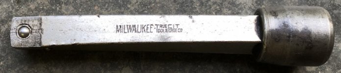

I was perusing some tools from a vendor at the flea with one of those big box trucks. He had a few tools out and I had already bought some stuff when I had the where with all to ask 'got any more tools on the truck'? He came out with a few more boxes of stuff. I found a few good things in the extras, but most interesting was this, only slightly twisted, MTF 3/4" drive extension. Someone had to put some real torque onto this thing at some point.
Marked Milwaukee True Fit Tool and Forge.
31,042
That's a cool 'tweener piece. Harkens back to the early detachable era, just after pressed steel, and just before hot forged, when extensions had square shanks with forged sockets with female ends press-fit or welded on the other end.
