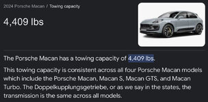

The Macan is rated to tow 4409#, a uhaul trailer shouldn’t be a problem. Their 6x12 utility trailer has a GVWR of 4400#. I went through this decision process a few years back when I sold my diesel pickup and was left with just the wife’s SUV. Renting whatever I need at the time from uhaul for ~$30/day won out over spending $2000 on the 5x10 utility trailer I was looking at.

Note that 4400 lbs is for a braking trailer - not too surprising in that at 4400 lbs the Macan is towing its own weight. Also get ready for sticker shock if you don’t already have the towing package - it was over $1k for us just for parts…
