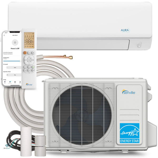

I bought mine about a year ago and it was sold as the 'S5', and I can confirm that it is a Gree Sapphire. I bought it as it seemed to have the best cold weather specs of any of the direct to consumer models at the time. It looks like they are now selling the 'XS5', which I would assume is the latest Gree Sapphire, but you would want to confirm that.
Pembol said to look at the remotes so I think this is a Senville unit - specs appear to be the same as this unit which costs $1700 from Senville (and includes a 16' install kit) vs $2539 from Alpine with no install kit. Have not looked at shipping cost yet (Edit: Free Shipping) but seems like Senville purchase is the way to go. Am I missing something?
pembol
Feb 13, 2014
276
Doing a google image search on that remote suggests it is actually manufactured by Midea. I don't see why you shouldn't buy it from Senville or which ever company is selling cheapest - it is probably sold by others with different labeling.
I also did the google image search to find the Senville and yes, the remote looks the same on the Midea. I see that both Gree and Midea manufacture for Senville and apparently also for Alpine/Blueridge. I could not find the detailed specs on the Midea badged unit to compare, only some general specs.
