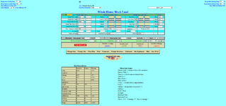

u3b3rg33k
Dec 18, 2017
4,051
if you're doing minisplits, you could consider larger units if the price is right. just check the data plate for the turndown ratio and you'll know how "small" it can get.
for example this 4 ton can turn-down to 1.3 tons:
