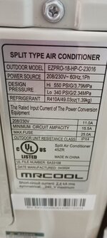

Check my plan for wiring a Mr. Cool 18k unit, as I think I'm wrong/their chart *****:
12-2 NM-B
25A breaker
Non-fused disconnect
Well physical unit arrived and, surprise, is marked differently then the manual online.
  • new manual calls for 15.5A MCA, MOP 25A
    • My plan is still 12/2 on a 25A breaker
  • unit is marked Max Fuse 25A
Question 1: other then code, what is the purpose of a fuse instead of breaker? Seems to be a lot of thought online this is an unintentional discrepancy with the manual
Question 2: is there a minimum height for the exterior disconnect? I'd like to exit the basement in a joist bay, which leaves the disconnect lower then I'd normally mount one. Other option (I see) is a interior junction box, thwn and an LB/conduit up the exterior, which is less then desirable.

Code says if spec says "MOP" then fuse or breaker is OK, but if spec says "Max Fuse" then a fuse is required.
Spec says both....
nameplate on equipment is controlling. Specs change faster than the documents fairly often, or components are changed without updating the user manual.

Screenshot the nameplate and post it here
I stupidly didn't snap a pic when I had it out of the box.
I clearly says "max fuse"....
I'll get a pic later today or tomorrow.

Where I come from a breaker would be sufficient. In this setting "max fuse" would be interpreted as meaning maximum setting of the over current protection (be it a fuse or breaker).
Wrong
A breaker and a fuse have different trip/blow characteristics. They are not the same. Theres a reason the manufacturer says to use fuses and code requires you to follow manufacturer instructions. So what youre doing is a code violation

did you miss the nameplate pic in #12

you go by the nameplate not the ****** manual which may have been translated a few times
I bought a fused disconnect today. Just annoying....
So with a MCA of 15.5, would you breaker this at 20 or 25A?
If 20, try a 20A fuse?

i would just use what the nameplate says- 25a fuse. for the breaker in your panel you could try a 20a

I ended up going off a sub panel in my basement to shorten the run, so used the 25a breaker (the 20's are unused in my main panel).
After a second measurement I drilled through the top of my band joist and came out high enough to mount the disconnect. With the amount of spray foam on my sills and only having 2x4 wall there was no way I was drilling blind from below and feeding wire up through the wall without a struggle.higher might have been nicer, bu you can pull the fuse standing up so I'm fine with it.
