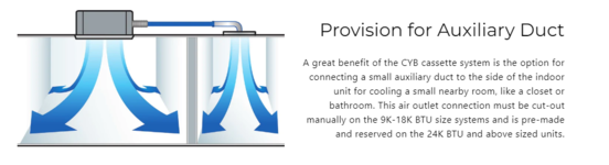

I have been looking at a Pioneer 18k ceiling cassette to put in my family room renovation. Lately, it has been marked as "Sold Out". I am about to call Pioneer to see if/when they might be coming back.
In the mean time, what other options are there? I know everyone seems to have a favorite brand, but I am more interested in what to AVOID (and possibly why).
One of the features that attracted me to the Pioneer was the option of an auxillary duct that could be used to feed a closet. Have not seen that on the few that I had a chance to look at today.

1a. The "auxiliary duct", as mentioned, would feed air to a closet, not run the lineset through it.
From their literature:
