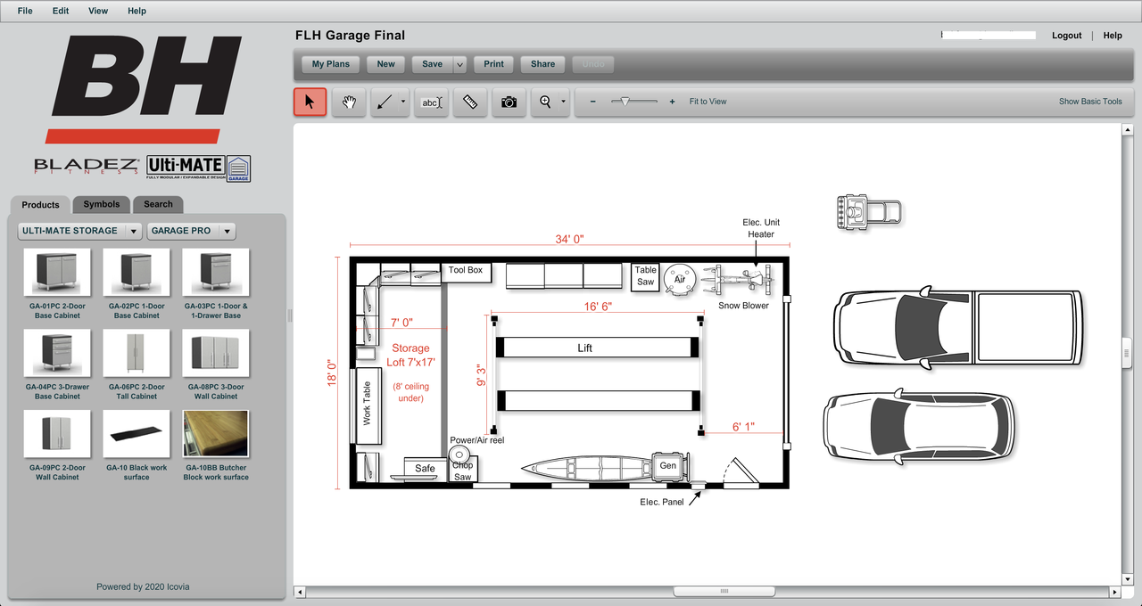

Use a layout tool. I found a free tool on the Ulti-MATE cabinets site. Used it to layout the garage interior. I ended up using NewAge cabinets but the tool was helpful.
