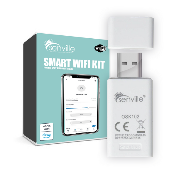

Yes i noticed that the price difference was very minimal which urged me to go with the bigger unit as well. Glad yours is working out for you. How does the app work? Can it work with Alexa/Google? My entire shop is smart so I would like that functionality too if possible. Senville seems to be the best bang for your buck from what I have seen too with good reviews to back it
Unfortunately the app is pretty basic. It has since been updated since I installed mine so maybe it was fixed, but getting it connected to the internet was a bit quirky but once connected I've had no issues. It does what I need it to do. No Google or Alexa compatibility that I'm aware of. I wouldn't mind this too.

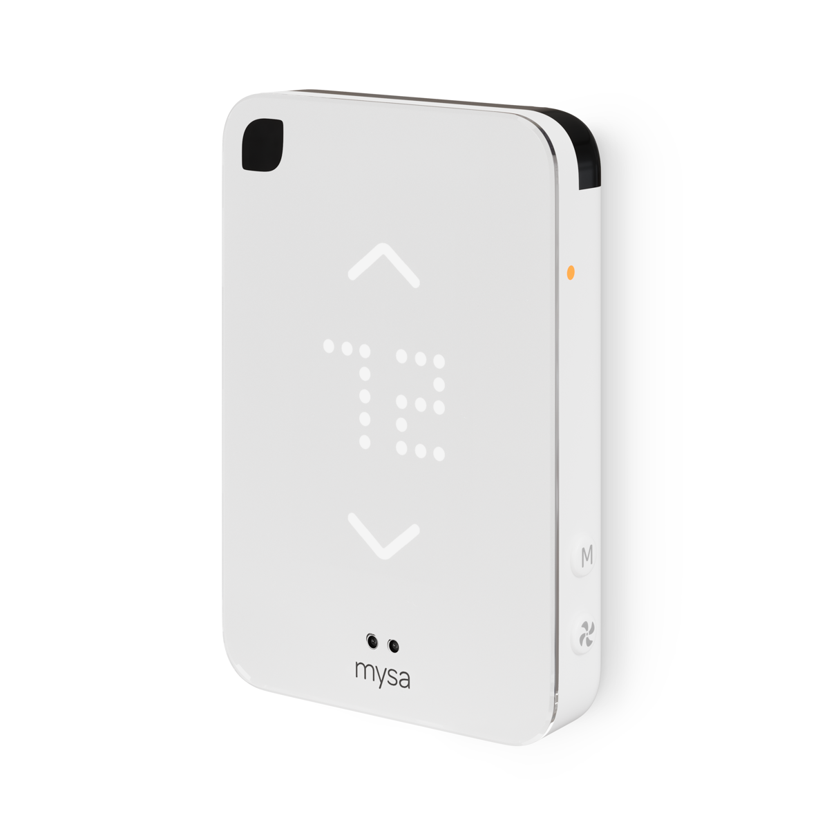

Does anyone know of a brand (sub $1500) that can be paired with Google Nest or at least use the Google assistant?
