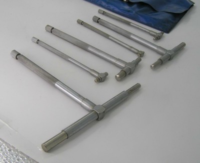

Nice Dark, I have the exact same micrometer, but sadly I recently pulled it out after sitting in a drawer for the last four years and found that a lot of the anvils were completely deteriorated and eaten beyond repair by the black foam in the case that crumbled, falling onto the mic and anvils eating the metal leaving large eaten pitted voids in the metal, it's not rust.
I’ve been meaning to make a general post about warning other MIT. tool owners (or potential buyers) to look out for this issue that seems to be fairly common in the older orange cases. It's the black open cell foam that is on the roof of the cover or the lining layer on the bottom of the case. When I have time I'll pull it out and take some pics of my interchangeable anvil; its rather sad and I'm in denial thinking it will be just fine with a little little cleaning.
Here's a pic I already had of my inside mic., luckily it doent effect performance and most of it is on the backside. I changed out the case so it's not the one in the background. I've actually come across quite of few Mit's with this issue, again sadly I myself have quite a few like this.
PS> Thats a nice Royal spindle live center you have.

VCI paper is awesome stuff (thanks for the link) and can confirm that it does work. I've also had really good results placing desiccant bags in my drawers with full of of milled steel tooling like v-blocks, parallels.........etc, its been years with no rust or signs of oxidation.
In regards to the foam in orange Mit. boxes, I remove the top and bottom lining foam, the shaped cut outs do not seem effected. Unfortunately I had a couple of cases that used the bad foam for everything like this depth micrometer case. This pic was taken '17 and this is the way I found the foam inside and the pieces inside were destroyed. I tried to save these rods, cleaning them up and removed all the foam stuck to them, they had almost rock hard clumps of the foam stuck to it that had to be carefully shaved or scraped off.
All the pitting had a black coating inside them. As you can see after fully cleaning them the rods in the middle (well all of them) were toast. Click on the pics to expand them and hopefully you can see the extent of damage.
I can tell you this depth mic and rods were new and never used except opened to prep and wrappings for the rods were removed when bought to check and make the set ready to use when needed. Big mistake

Here's what I was talking about. It *****. All the anvils are ruined.
I'm thinking it was the acid in the foam and one of the reasons why the foam failed in the first place and then falling onto the tooling, eating it or maybe causing galvanic corrosion?

Oh man Macgee, that ***** donkey balls! I'd literally cry & be mad at the same time if that happened to me. These sets aren't cheap either, even used, & the anvils are crazy expensive. Really breaks my heart to see that!
Not much you can do about the satin chrome but maybe evaporust might clean up the anvils? As long as you don't leave them in long enough to the point when they start turning black (I think it's the carbon that gets pulled to the surface or something like that?).
I wonder what Mitutoyo would say if you contacted them about it? I assume they wouldn't warranty it though even though I think they should. I'm sure they are very aware of this issue.

Thanks DZ,
I found the perfect fix for this problem: Denial!
I'll occasional open the case because I forget what's in it, I see it and then put it back in the drawer pretending I saw nothing wrong :)
I just wanted to warn others looking for used Mitutoyo or already have some stashed away in a drawer. It's the thin top and bottom sheet of foam, not the shaped cut out foam. Just remove the good cut out shaped foam and scrape off the top and bottom, replace with something else, thoroughly washout the cut out foam to make sure there's no residue of the bad foam on the cutout and put it back in. It's a pretty easy and quick job.
Not sure if any of the anvils can be saved, the corrosion by whatever its caused by eats really deep holes more than compared to rust.
You're right, the anvils are super expensive like $40-$50+ each. I use evaporust in a heated ultrasonic cleaner almost everyday for my restoration jobs, when I get around to having some time, I'll attempt a rescue of them. I pretty much written them all off, I'll clean it up and save as much as I can and let a new owner take the challenge at a smoking price. :(
I actually comes across this often at flea markets when people are trying to sell off their older meteorology items. Etalon is another that has this problem. Maybe it's just the LA air
