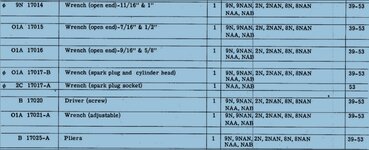

Ed in Virginia
Jul 30, 2022
206
Montpelier, VA
So what would these Ford tools have been for?
The first wrench (open end - box end) is a spark plug/cylinder head nut wrench for 1940 Ford cars and early 1939 Ford 9N tractors.
The 9N-17014 double open-end wrench is actually a plow wrench, used to adjust the Ford Dearborn plows. It's a common misconception that it was used to measure gas in the tank - probably not a good idea to be banging a metal wrench against a metal gas tank near gas fumes.

My Ford wrenches are in the tool box on my Ford 9N tractor, which is where I got them, and they'll probably go with the tractor when I sell it, along with the original advertising and manuals. I'll have to see if I have any pictures.
An early 9N had the most complete tool kit as Ford started eliminating them as the N model progressed. This is a list of what came with early 9N's:

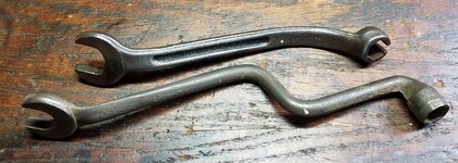

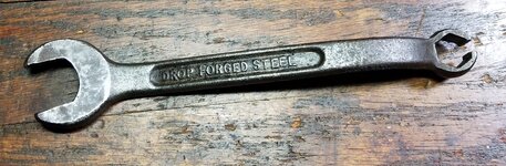

30,947
Calling @Ed in Virginia, @Ricky Joe or any other Ford Model T and A era tools guys...
Little help needed, please.
I found this in a mess of old tools at the flea market yesterday.
I don't collect Ford tools and normally I don't even give them a second glance, much less pick them up, and never bring one home. But anyone who has ever walked through a flea market in an industrial state knows the familiar bowed shape of a Ford spark plug and cylinder head bolt wrench, they're so ubiquitous.
But I did a quick Wait...what? when I saw the panels on the shank and the flare nut type opening in the box end. I have some specialty automobile and aircraft spark plug wrenches like that, but I have never seen a classic typical Ford suitcase wrench with that end. It's possible it was user modified. I did not inspect it that close.
Secondly, I have never heard of 'Walker Turner' in any capacity other than machinery, that 'Walker-Turner' had a hyphenated name, and, as far as I know, was always located in NJ - at first in Jersey City, then the Plainfield area - not New York. I DO have some Walker-Turner wrenches, but they are marked 'DRIVER' and unmistakably for tool posts and such on their machinery.
I am guessing there were a bunch of variants and plenty of knock-offs of the 17017, but searches on Google Books on 'Walker Turner' just returns documents referencing the machinery company, adding 'New York' to the search string also returns only the machinery company, and adding 'Ford' does nothing.
Is this a 17017 knock-off? Have any of you seen it before?
It's 1" (open) x 5/8" (flare nut).

Lugz, that's a new one on me. I've never seen one like that with the flare nut type end, nor have I seen that mfg name on a Ford tool. Pretty cool!!!
30,947
Pretty cool!!!
Thanks.
Are we sure it's a Ford tool? Are the openings consistent? If the openings are right, I would love to be able to claim a rare and possibly heretofore unknown or unrecognized variant. But I am trying to eliminate any possibility that it could just look like one in shape and general configuration.
I'm not sure it's a Ford tool at all. The open end on many spark plug/cylinder head nut wrenches is 1-1/8". Is the flare nut end on yours an owner modification or does it look like it came from the factory like that? The attached document represents research done for the National Assoc. of Ford Tool Collectors but is not the final word on this topic by any stretch.
Thanks, Ed. So, a 1/8" shy. What is the specified diameter of the box end? If it's not documented, please measure a few of yours.

Actually there were two sizes of spark plug wrench: 1” and 1-1/8”. So 1” is still in the running. I used to have a set of Craftsman Ford wrenches. I believe Scott Carter has them now. Perhaps he could measure.
30,947
Good to know. Thanks.
You don't have a single Ford suitcase wrench in that "blue million" strong trove of Ford wrenches you said you have!? I'm going to have to mentally strike you off my 'old Ford guy' list. :)
Seriously, though, someone please tell me the size(s) of the box ends. I already found it odd that the references Ed posted only mention the open end as if the box end didn't matter.

//// BREAK ////
It's hard to believe just how many scattered threads we have had on Ford Model T and A wrenches, literally dozens, but not a single dedicated thread where we can consolidate information and examples. I'm not even a collector and I think it's nuts. Maybe we should just get the title of this one changed.
Calling @ttpete! Please read post #68 and thereafter and share your wisdom and references!
Calling @Oldtuleguy! Please measure the openings in the box ends on the 4 or 5 **-17017 wrenches you picked up back in April 2019.
In addition to far-flung 'Look what I found' old Ford tools threads in which nobody provided the opening sizes, searching GJ on 'Ford spark plug and cylinder head wrench' also turned up an old @Leviton post in the 'Buffum' thread, of all places, linked here, in which he shows a Buffum wrench and says the following...!
Looks to be a Ford spark plug and cylinder head wrench (I'm assuming it would be a T-5893). I didn't know Buffum made these.
Has 5/8" and 15/16" openings and is 10.9" long.
Pretty darn close to mine, and exactly the same opening on the box end.
That made me scrounge around from one corner of the Lugzsonian to the other, looking hither and yon, with the little gears grinding and cobwebs and smoke coming out of my ears, hoping it would come to me...and it finally did!
I have this very early double offset Herbrand...
...with the exact same measured openings - 1" (open) x 5/8" (box) - as the Walker Turner!
By 1937, the earliest Herbrand catalog I have, model No. 2336 was used on a puller. It does, of course, advertise a Ford spark plug and cylinder head wrench and it does, of course, provide the openings. That's a bad scan, but those fractions read 5/8" (box) and 15/16" (open).
I am starting to think my Walker Turner wrench - which may be a little oversized on the open end, or I am measuring a tad coarsely, is, indeed, a Ford spark plug and cylinder head wrench.
The question remains by whom?! By the famous machinery company? (Lo and behold, according to the experts on the W-T thread, it was originally incorporated in New York!) Or for the famous machinery company made by someone else?

Lugz, I pulled several spark plug/cylinder head nut wrenches out this morning and measured them for you. Ricky Joe is right, there are two versions of the early ones that are 1 or 1-1/8 AF on the open end. I only pulled wrenches with the hex box ends - Ford mandated a change to 12-point BEs in 1940.
The hex BE on the Model T (1908-27) is 21/32"
On the 81-A 17017 ('38-39) it is 3/4"
On the 40-17017 ('33-38 85hp V8) it is 23/32"
Hope this helps some..........Ed
I would agree and I also think it was user-modified. I have seen more than a few Ford wrenches, some with decent collector value, that were ruined this way (again, from a collector's perspective). As mentioned by another poster, folks would hang on the Ford script hand tools, but at some point may have needed a wrench with a size they did not have so they opened up the open end or in your case, converted the hex box end to a flare nut wrench. The "cut" does not look quite centered to me.
