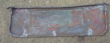

Been working on the tailgate. It is all bent up and has multiple cracks. I got all the cracks welded up yesterday and some straightening done. But more to do.

Top rails are in good shape, the rest generally speaking is not bad. The tail gates are always beat up. I contribute that to the loads carried a 100 years ago..Like lumber or pipe hanging out the back.
The 34 I built, the top rail behind the driver up by the back of the cab, was dinged and bent. Decided tools like shovels or farm tools were hauled some time in its life. Then there were the typical bullet holes ...LOL interesting to try and decode the history of the parts.

It's amazing how much abuse these things take and keep on working. I've spent 2 days on the tailgate. I must have welded up a dozen cracks in the sheet metal. It was badly twisted and bent too. I replaced a broken hinge and will replace the tailgate latches that attach to the side of the bed. The tailgate is about 90% straight and it closes pretty well.
