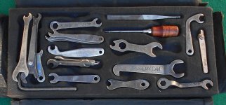

I purchased an older tablet that can take small pictures.
My close enough attempt at a 1914 tool kit for the T.
And a couple other T related tools. IMG_20260522_174342.jpgIMG_20260522_174357.jpg
pretty sure your little magneto wrench is a GW-1 Gilfillan
it's rather unique
Gmonkee
May 9, 2010
3,082
I am amazed anyone else knew what it's for. Now I know who the stylized GB logo is. And it bears a GW-1 stamping.
The one I can't guess is the SOE which appears in Ford service bulletins for the early years of the T. It's there, 5-Z-821 is the number but no marks on my wrench. I was unable to determine its use also.
I was always curious if it's the real thing or just similar.
29,774
It's a rather odd duck. I don't know of any other manufacturer who made one like that, and that piece is NOT included in the WK2 set.

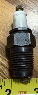

Ayrhead
Feb 23, 2020
602
Ontario
I’m wondering if this Dominion Spark Plug was for the Model T Vehicles…
