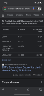

Ozone detection has been confirmed.

Had a meeting with the owners today things went well. We believe that the source of the ozone might be coming from the fan on the exterior of the Modine heater. Tonight I’m going to turn on the heater and see if It sparks. Im really hoping this turns out to be the source of the problem and & an easy electrical fix, with no more ozone emissions.

EPA ground level ozone standard
