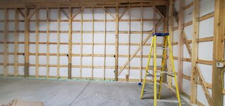

So I've been working on insulating my barn and got the ceiling all blown in and about half the walls the done. For the walls I ran 2x6's vertically at 24" OC as I'm putting drywall over it. I've got almost all of it insulated with R19 except for a 24' section of wall and I've got drywall over about half of it now. I had to pull some insulation back yesterday to build a frame around where the exhaust for the heater goes out the wall and it was pretty wet. Its steel sided with Tyvek behind the steel and the Tyvek is good and sealed. I thought maybe it was maybe because of the hot exhaust from the radiant tube heater going thru the cold steel where it really wasn't insulated yet. I'm in Michigan and its been going from 50 to 20 within a day or 2. Well I reached behind a few other bays of insulation that arent drywalled yet and some were damp and a little wet, others are fine. What's going on, is it because I don't20221203_184732.jpg20221211_174153.jpg20230218_155437.jpg have everything covered yet?

I‘m guessing simple condensation. Tyvek will let the vapor pass to the drying side, eventually. Even double tyvek is permiable to water vapor per the manufacturer. Once it’s done, I’d hope that less warm, moist air will be able to get to the cold interior side of the steel.

That would be my guess too, that you're getting warm air passing through and condensation forming on the colder tyvek. Like lowerthanu I'm not a fan of faced batts as you get a lot of leaks. You probably have quite a bit of air leaking between the batts and the uncovered vertical 2x6's that you can see in your pics.
The other way you could get water coming in would be a leak from the roof but that would be pretty easy to rule out.
ETA: What are the building codes like in your area for vapour barriers? Here I think you would still need a 3mil plastic vapour barrier on top of faced batts to get a good enough barrier.

For the amount of time it would take I would remove all the Sheetrock and get a vinyl vapor barrier, (thick stuff as it makes it easier to apply without unnecessary rips). I purchase some from Walmart (on line delivery) a while back. Make sure you tape seams and make outlets air tight.

Not sure on the building codes. So the vinyl vapor barrier would go over the insualtion and then put the drywall on? In my other barn that I built about 20 years ago or so I used insulation from Menards that was actually wrapped in plastic all the way around making it much easier to deal with plus i bet it sealed better than the paper faced stuff. I couldn't find the plastic wrapped stuff anymore, the guy at Menards had never even heard of it. It was from the Johns Manville.

The whole wall probably leaks a lot more air than you think. Warm air is condensing on the cold tin. Tyvek probably letting air by at the top and bottom. Interior vapor barrier has a hole in it everywhere you put an outlet box.

Is it damp on the interior side of the tyvek or the exterior? Is there an airspace between the tyvek and the steel? Is the building conditioned yet (heat or cool?)
Educated guess here but sounds like you probably need to apply a vapour barrier to the interior side of the insulation. There are paint based vapour barriers available that you can apply over drywall. If you don't have an airspace between the steel and the tyvek you may have effectively turned the tyvek into a vapour barrier instead of an air barrier. It's hard to say without more detail, but the solution to that could be adding vapour barrier to the interior.

Warm air is not really relevant here. Warm air has the potential to be more moist and condense against a steel wall at night in the frozen north. But the moisture itself is the problem, not warmth. Where is the moisture coming from? Can you eliminate it?
I'm an engineer, but I don't know really all the sides to the debate about vapor barriers. In Michigan I would have said put a plastic sheet on the inside so that the air inside the wall is outside air. But somebody else may take another stance on that.

The main issue with steel buildings, EVERY metal seam needs to be sealed before the insulation, then plastic before the Sheetrock ( unless your spray foaming). Your metal seams allow air flow, even if it is only between the metal seams; any air flow will bring in moisture. Without plastic and thorough sealing around electric boxes/pipes etc , your adding even more air flow to bring in even more moisture.
With plastic behind the sheetrock I would use Alkyd paint for priming, not because of water vapor through the wall but from condesation forming on painted surfaces due to moisture coming from the interior air, Latex can be the top coat. If latex primer is used paint can lift, especially around areas joint compound is used ( over time), basically latex ***** when moisture can travel through it .

This is a typical problem with insulating metal buildings. If you notice all heavy steel metal building have insulation with a vinyl barrier that goes against the metal. Metal will sweat when there is a temperature difference between the inside and outside. Heating the building doesn't help at all. The other problem that might be happening is that without any type of wood substrate on the outside of the building, you are bringing the dew point into the fiberglass batt. In typical wood framed construction we only see this as an issue in cathedral ceilings that do not have an airspace. in those instances IRC does require a rigid insulation against the decking. Not saying that is the case here but could be.
About the vapor barrier. The IRC only requires a vapor barrier to be installed on the "warm in winter" side if the exterior cladding is not breathable. I would in my opinion consider that metal siding (guess a PBR style) to be breathable. I idea of the vapor barrier to to allow moisture from the inside of the building to pass through the gypsum and out to the exterior. Looking at the photos above it doesn't appear to show any logos on the moister barrier. Have they used an actual moister barrier of some other type of product? A true moisture barrier should allow moisture to pass from the unprinted side to printed side but not the other way around. Check into what product they have installed under the metal siding.

The main point of vinyl plastic is to stop air movement, within the wall structure, which in turn stops moisture migration. A breathable moisture barrier as in Tyvex is only efficient if there is a minimal air change within the wall envelope.

Tyvek itself is an approved air barrier when installed correctly, so as long as OP's builder installed it properly then the Tyvek will be stopping air from moving through the wall.
Vinyl plastic vapour barriers are designed to stop vapour from moving into the wall via diffusion. It can also function as an air barrier but the Tyvek and drywall will be doing 99% of the air movement control.

Obviously the OP walls are not air tight, just as most installs involving Tyvex are not.
Secondly Tyvex allow vapor to move throught it, but not at a high rate, so moisture can build up in a wall cavity. Then, if the sheetrock side does not have a means of blocking vapor such as plastic, sealing paint and tight sealing of outlets, vapor will enter the cavity from the interior side; again if there is no means of sealing , air will move in the wall cavity be it from the exterior or interior. So in this case the OP need plastic just behind the Sheetrock, fully sealed unless he wants to remove everything down to the bare metal, and seal EVERY seam and opening on the metal wall air tight; even then without plastic you would still get some moisture entering the wall cavity from the interior.
