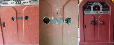

I used jbweld to fill the holes in a Lincoln AC225 where I wanted to make the leads removable. I use a piece of wood wrapped with plastic wrap from the kitchen. Used clamps to hole it in place on the inside and it came off with no problems. I also sanded it after I was sure it had dried.
