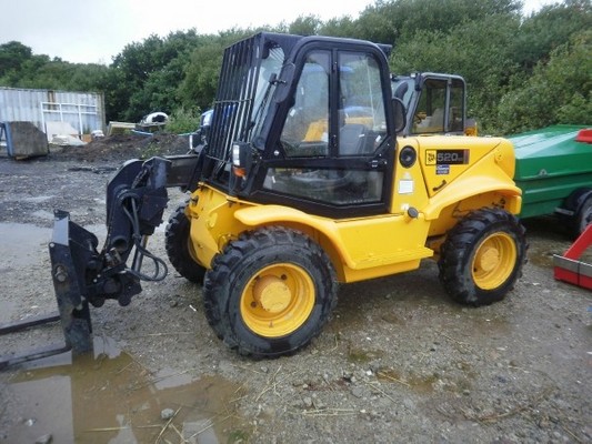

You could also do it the safe way and rent a piece of equipment! A JCB 520 or something similar would do the job without risking hurting someone! :beer:
