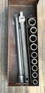

Picked up this 3/8 drive set off eBay last week! I threw in my other spares in case someone needs some? Paid $30 plus shipping. It’s missing a 9/16 and a 6” extension and hinge handle if someone has those? Exterior is rough in terms of paint so it will get a repaint this summer for

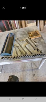

SpeedMaster set on FB MP.
1940's Speed Master Frankenstien 1/2" socket set, originally had lifetime warranty from Wright Tool. Seaside, OR $100

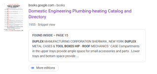

There would be no reason to be surprised by Duplex as a supplier and plenty of reason to expect it - since we know as a matter of fact that they were making and supplying the large rollers and top boxes for Plomb in the 1940's, establishing a relationship for toolboxes, in general, and we know as a matter of fact that they were making the hip roof flip-tops, in particular, for Pendleton Tool Industries, Inc. - as part of the PTII empire - at least as early as 1958, when PTII bought them out and moved them to Ft Smith, AR.
But I have absolutely no evidence to either support or refute that theory.
Nor I. All I can find is an old post of mine in the Plomb thread identifying a box that Mintgrun found as Duplex. I gave no rationale at the time - other than explaining to him why it could also be McAleer based on construction, but not the other known makers - Hamilton, Union, or Waterloo. I was undoubtedly thinking that PTII's later acquisition indicated they had already been using them as a supplier. My matter-of-factness leads me to believe I had provided the rationale somewhere else, at some other time, but I can't find it.
The earliest I can date Duplex to making hip roof flip-tops when they were still in Sherman, NY, and independent, is 1955.

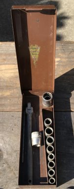

Come across a fair amount of plomb out west here. Grabbed this guy at a swap meet pretty cheap.
