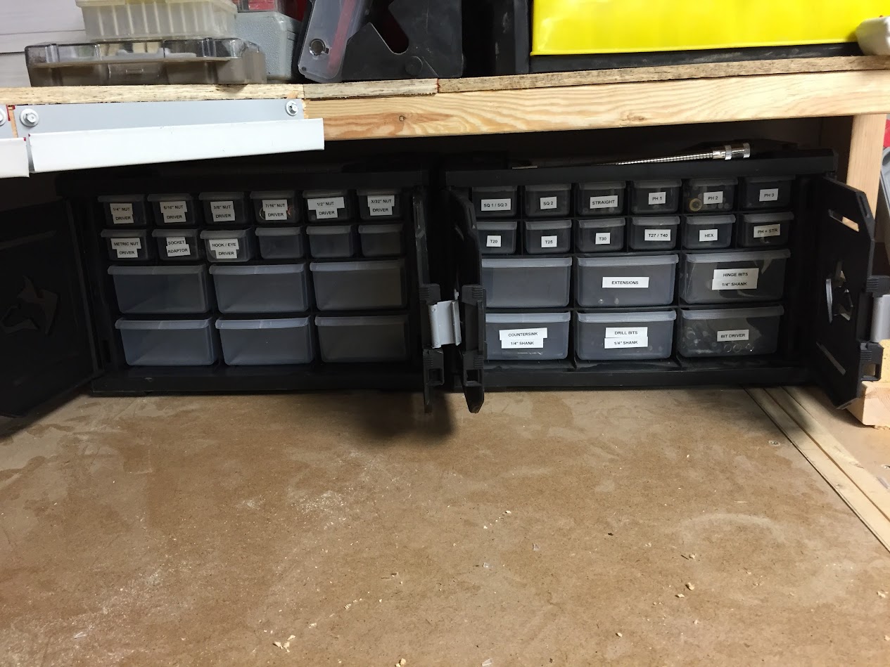

Then I finally created some storage for the million driver bits that I could never find, that were piling up. Went for the traditional pull-out bin method, now it's super easy to find what I need and always put it back where it belongs:
bLIXbpPdxtVXXRIeQs80k3h5fXQLG2VBeHauMQ-2KyC8=w1266-h949-no
FL_rNNZFa3jUdgYoT8T4GfAGGR9tLf7sbv_Aui4Q5sPP=w1266-h949-no
and added a plano box for the small bits that don't directly chuck up into the driver:
